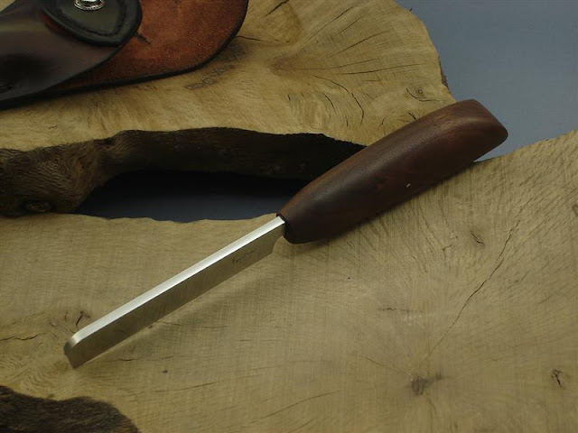

A couple minutes ago I've made another mortised tang reed knife. The knives I do have no guards or bolsters. You need to be sure that inside of two slabs have little scratches or drill holes that the bond will be very strong. Also You need at least one pin to hold everything in place, preferably a peened pin or a rivet like a corby or loveless type...
If you flatten the inside parts real good there is a chance that it will be impossible to see the glued pieces, use some of the fine dust of handle material to mix into epoxy you'll use.

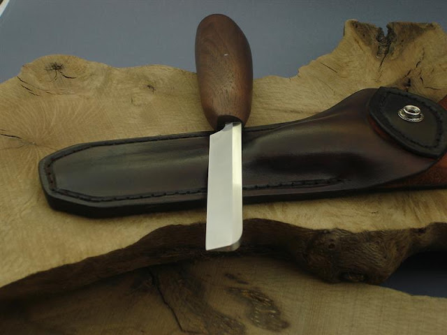

Here is a sample of mine reed knives:
As you can see there is no visible glue line...
Emre
There was a thread on here a while back....I think the general opinion was that a mortised tang was every bit as good as a once-piece wood handle....providing the two slabs were glued and pinned well. I guess even traditional Japanese swords were of the mortised tang type.
