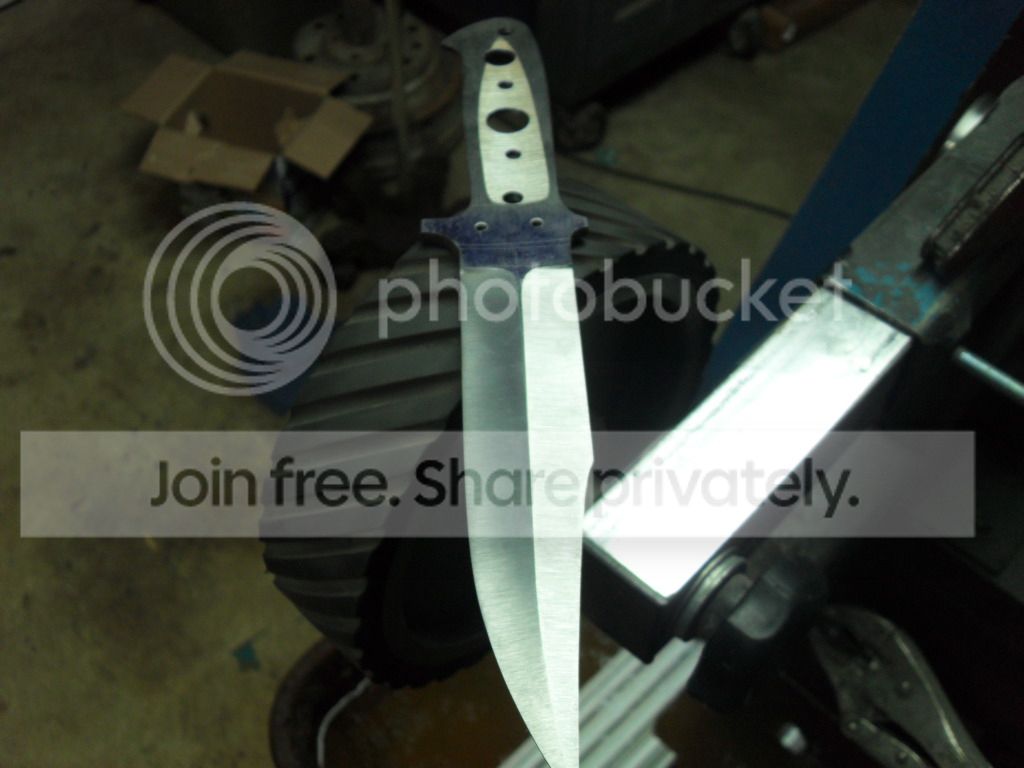

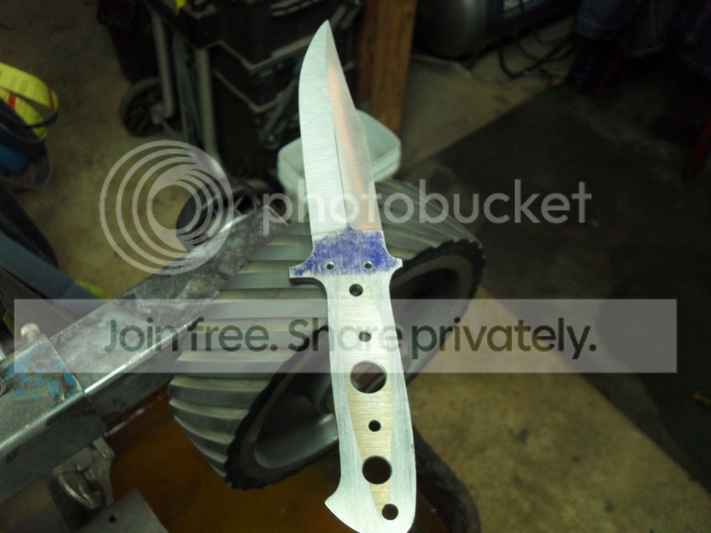

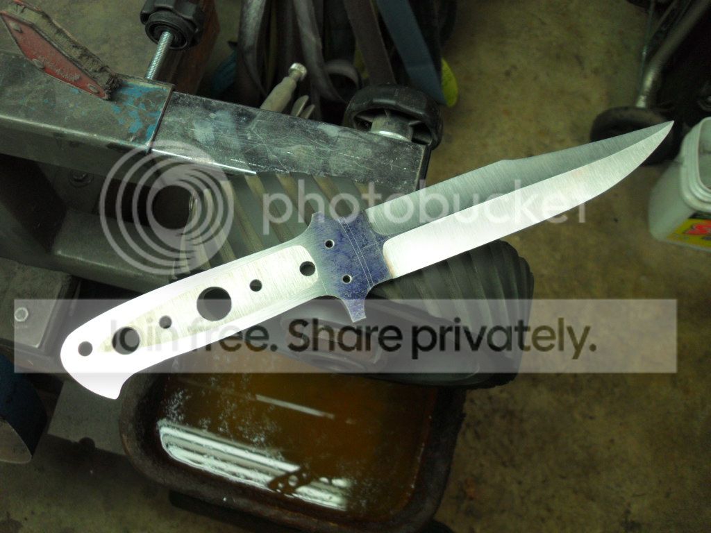

...is freehand on a small wheel, 4" in this case. I remembered Bruce Bump saying how he liked hollow grinding in a thread on his forum. Since tonight I needed some "fun" in the shop, I picked up this one and gave it a go.
Just as I remembered, FUN! :D
Of course doing the other side the same way might not be as fun. ;)
What's you preferred aka FUN way to grind?
I surely like your deep grinding, Pat !!! That's a real sexy looking blade that excites me even without seeing any sort of handle. For me controlled grind curves like that talk to me of real artistic adventures !!! Frank

Looks good Patrice. That top grind is a challenge with a 2" wide wheel. See if You can turn down another wheel to 1" wide and use 1" wide belts for the top grinds that have a curved tip and spine like this blade.

Bruce, I appreciate the tip. 1" wheel just made it to the top of my tools to get/make list. :thumbup:
