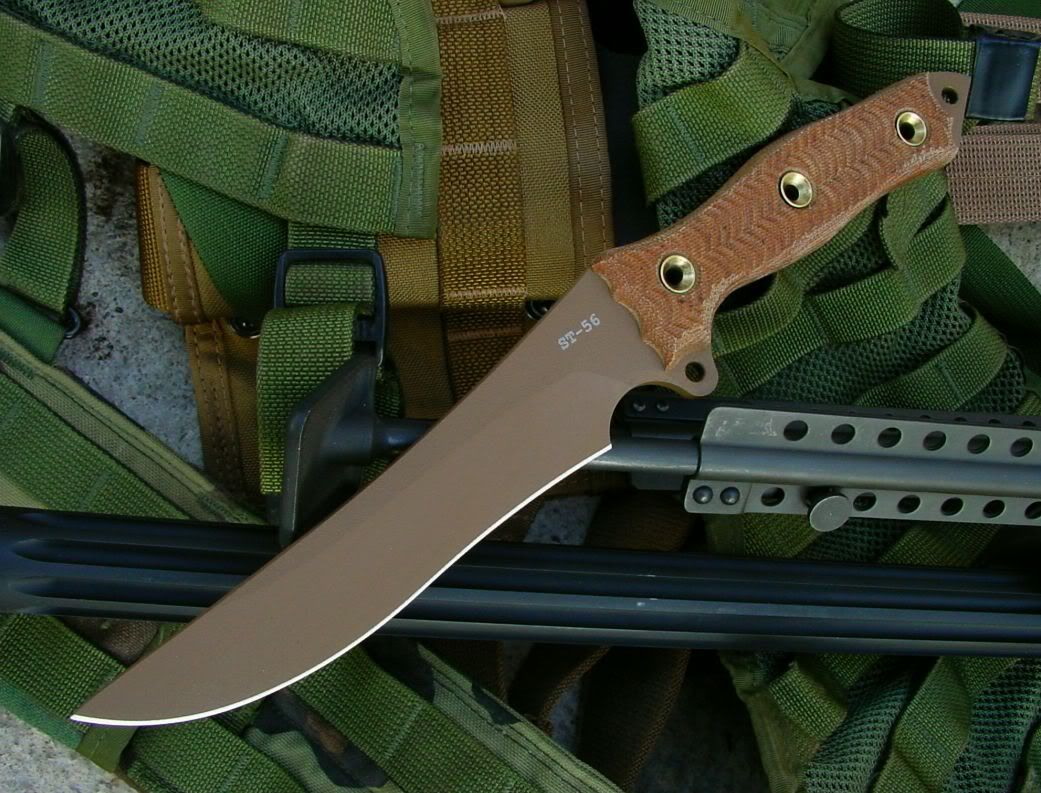

I don't know nothin' 'bout nothin', but this sure looks like it was designed with a fight in mind:
ST-56. If you posted a "wanted to buy" ad, I'll bet you'd get one or two responses.
ETA: I don't have an ST-56, but that sure looks like my Barrett that it's resting on. Except mine doesn't look that well used.

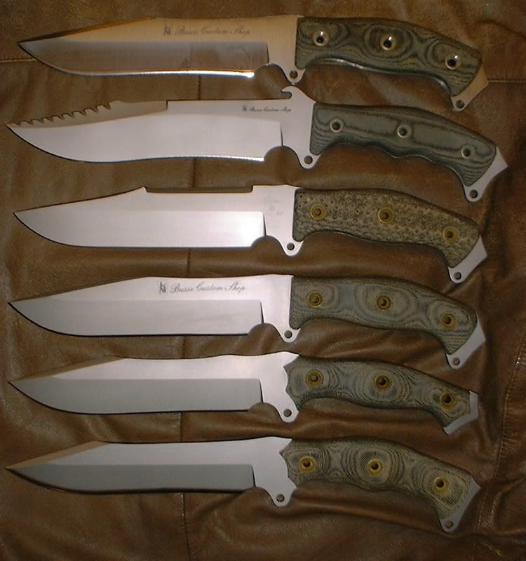

I'd probably pick one of these

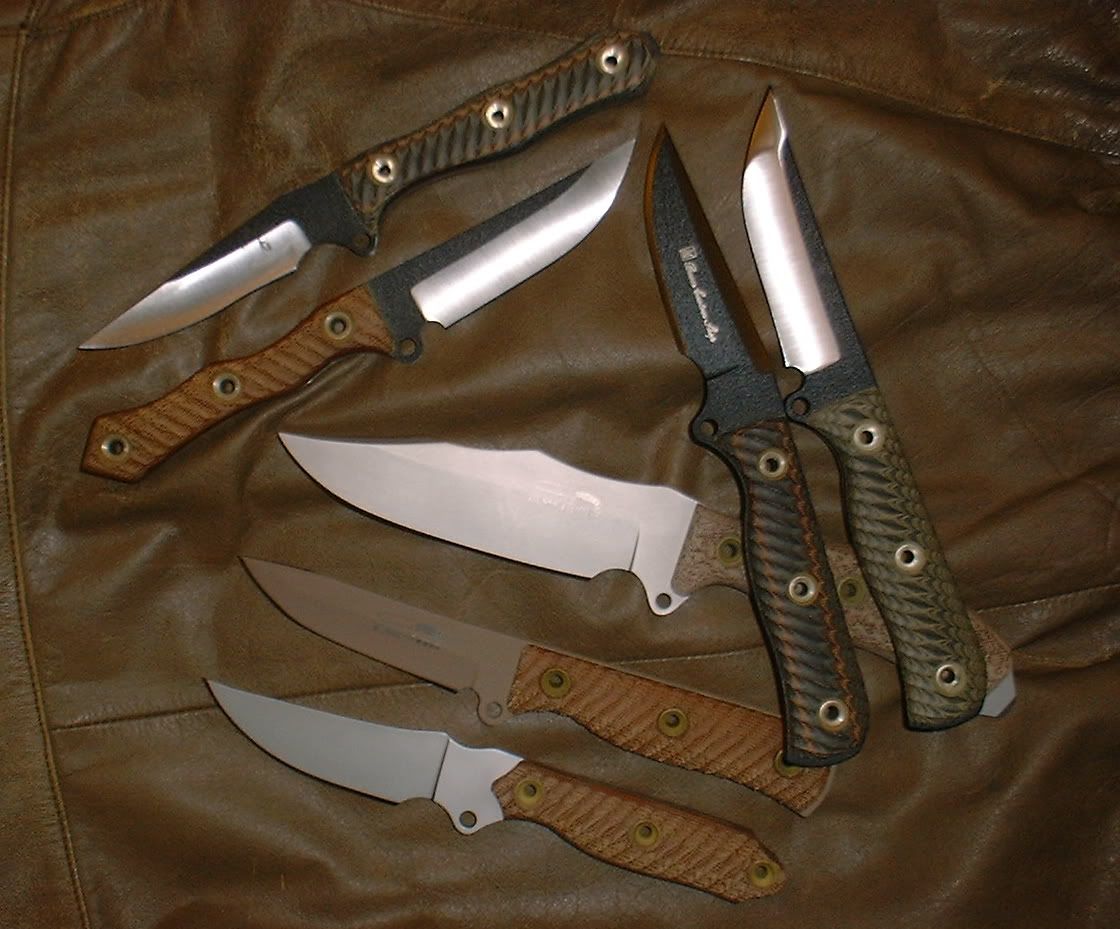

Or if I needed it to be more easily carried I'd probably pick one of these
What knife is above the Battle Ring Fighter? Also, what are the knives above the smaller ones? Thanks for the suggestions and help so far.
Poor, Poor Bully. He has so many great blades, he can't pick just one:D
Can you tell I'm jealous?:D
