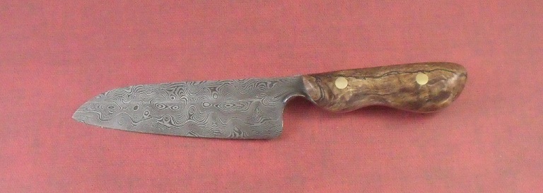

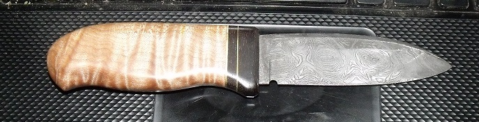

Hello all. Here's the knife I was planing on entering the KITH without an edge.
I'm not happy with how the sheath came out, so I did a second one, and not happy with those colors either. So I'd like to do a 3rd but don't want to waste the other 2, so is this design good enough to make a few more? If not, are there any modifications I should do? I realize they'll have to be limited...
Thanks in advance.

don't have the handle higher than the spine of the knife.
make some knife drawings on paper to get an idea of how lines flow and how ideas look
This is just an on opinion of course, but I wouldn't use a more expensive material like forge welded steel on a knife until I had made quite a few, and could be pretty sure it wouldn't go to waste of I flubbed the execution. I've made about fifty knives so far, and I still haven't used it. When I see a pattern welded blade I expect the rest to be flawless. That's just my opinion of course.

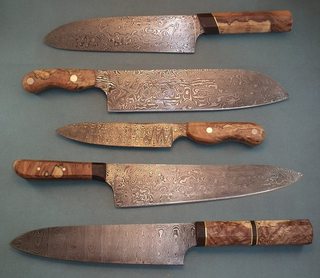

, and a few kitchen knives

Great looking steel Bill! The wood finish is pretty and the fit up is tight. It's obviously a personal choice, but I think the first knife in your post and several of the smaller knives you posted would look better with better defined lines on the handles and bolsters. I always think contrast can be interesting. So you have some nice curving on the spine for instance, if you contoured the handle sides between the butt and middle, it would complement and set off the curves elsewhere. Same for the guard, rounded sides, with maybe a tighter radius at the edge and spine side transitions. Think about bringing some of your wa handle geometry into the other handles. Kind of like BBQ- spicy is good, sweet is good. Sweet+Spicy= Fantastic! I hope that's helpful.
I'll offer some design critiques on the first knife, and a few comments in general on the rest:
1) The handle is quite oversize for the blade. It looks very fat that way. It most likely still can be reduced to a more comfortable and visually pleasing size.
2) As Kevin pointed out, having the spine of the handle above the blade looks off. If the belly is too low, or the from=nt of the handle extends too far down, it also looks unwieldy. It can affect the grip and cutting power if too far off.
3) I like the choil to be bisected by the plunge, not in front of it.
4) The blade part of of the other blades shown looks good. A few of the handles have too much curve and bulge, and are a bit fat. Remember that simpler is usually better. Look at the photo of the five kitchen knives. Three look like you would pick them right up and go to work. The two with the funny shaped handles don't invite you to use them.
5) Your damascius looks great. However, a kitchen blade made in carbon damascus is sort of asking for rust spots to show up. It is OK to do, but prompt and thorough blade care is essential with every use. I prefer stainless damascus, and especially Damasteel, for kitchen blades the will be used regularly.
