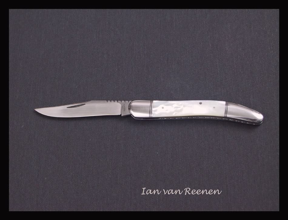

Blade: ATS 34 - Hollow Ground - Hand Polished - 60 Rc - With half stop

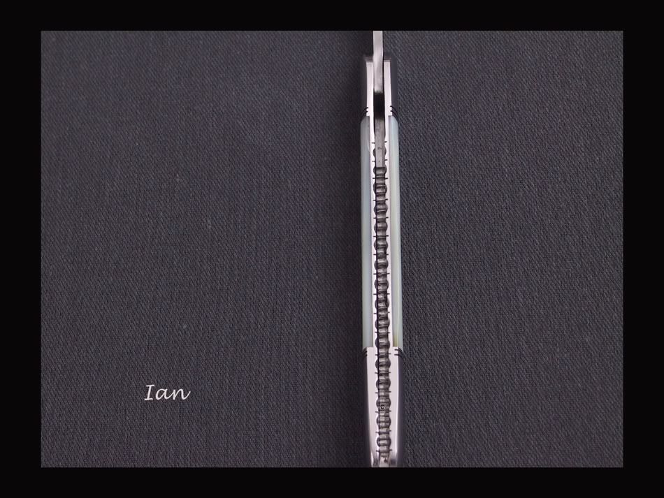

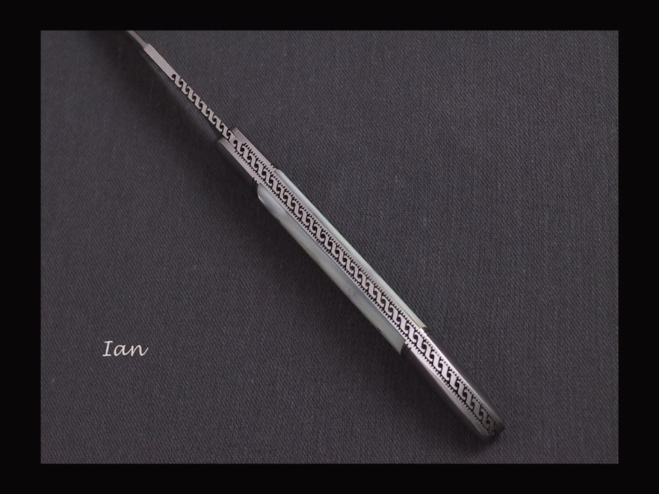

Roman Knot file work on top of blade and spring
Spring filed on bottom
Liners: 416 Stainless Steel - Relief milled and filed on bottom an top

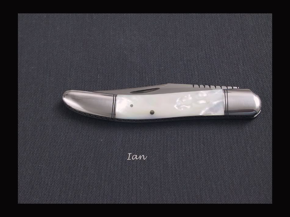

Bolsters: 416 Stainless Steel
Scales: Presentation Grade Mother of Pearl
This knife is a collectors piece, with snappy walk and talk. The blade sits dead center and spring is flush in all three positions. The pictures don't do the knife justice.
Thanks for looking

Beautifull toothpick and I really like the Roman Knot filework. Very cool.

Ian, that is gorgeous! I'm going to have to pick up a folder from you at Blade this year.
