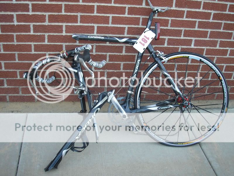

Or drive through a McDonald's drivethrough or hotel overhang with your 4,000 dollar carbon fiber bike on the roof rack....
:eek::eek:
Nice bike! Was... a nice bike, I mean. ;)
At a resort I worked at the valet did the same thing going into the parking garage. Resort had to comp. stay and pay for the $10k for the bikes, but it made a great video. ;)

The overhang has always been a big fear of mine, no I have the bed of the truck. Ugly
