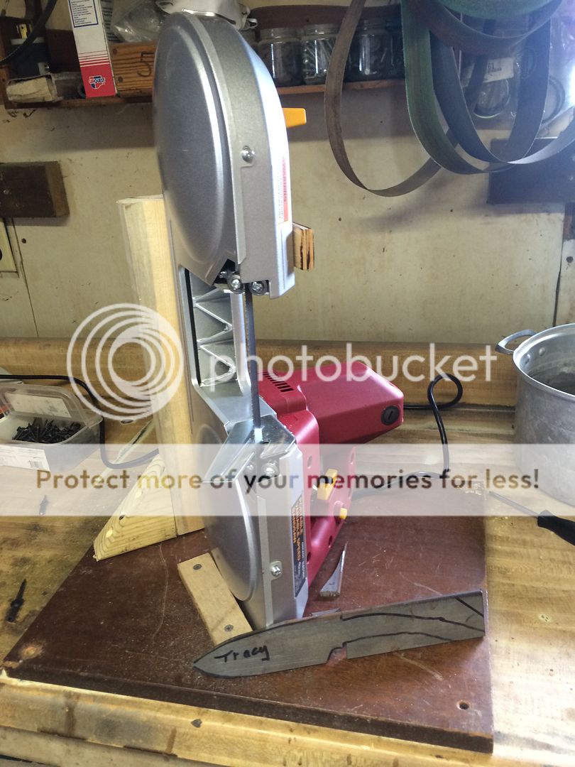

I should have my HF version of a Porta Band on Tuesday. I plan to use it almost only for cutting out knife blanks. It's time to ditch the angle grinder.
Can any of you help me please with instructions, pics, plans etc for how you mounted it vertically to make it into a bench mounted band saw? I've seen pics of the finished product but am unsure of the best way to build a wooden stand for it.
Thanks so much!
I just took off the top handle and fashioned an L bracket to hold it to a pine board backer and made a small shelf to support the bottom, leaving about 2 inches to clamp in a workmate type table.

Thanks everyone - here's how I did mine - very similar to some of yours. I will make a little plywood work surface like some of you did, but I just could not stand to wait to try it out. the blade in the foreground is my first cut - THIS IS SO MUCH BETTER THAN THE WHOLE ANGLE GRINDER THING!!!!

I wanted to keep the ability to just pick it up and go, so I didn't go the route of removing the handles and bolting it in place. I'm not entirely happy with it yet. It's plenty stable for using, but I might still add a couple clamps just to make it a little more secure.
The bar running across the power switch has a slot so you can push it down and back to lock it on, or pull it forward to turn it off.
You know the new table is backwards, right? The slit needs to face the other way so you can change belts without removing the table. Also, you might consider a leg on the table as the extra size puts a lot of torque on the two screws holding the original table to the saw.
