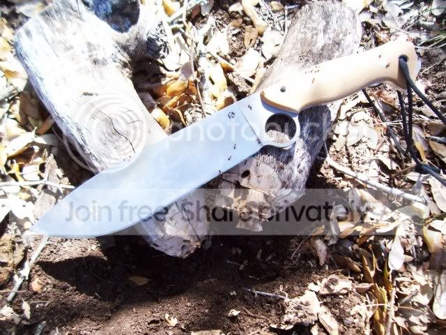

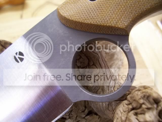

So, I took my new Survivor out this morning to do some work and get a little dirty. Here are the specs again:
Overall length = 16 inches
Blade
* 9 inches (sharpened), 10 inches to the front of the handle
* A2 steel, hardened to 59 HRc
* 1/4" thick
* 2.25" tall at the belly
* Flats will be "as-forged" finish
* "K" logo will be etched
Handle
* 6 inches (from front of the handle to the pommel)
* 5.5 inches of actual handle material
* 1/4" thick material (0.75" total)
* Natural canvas micarta
* 2 lanyards/tie downs (front safety lanyard = 1/4", rear handle lanyard = 3/8")
* 2 Corby pins (mechanical fasteners)
* Handle is large enough to fit an extra large hand "just right". The rest of us "non-apes" will have some wiggle room - helpful in chopping.
POB (Point of Balance) is "in the ring"
Ring is 1 inch diameter, chamfered inside/out.

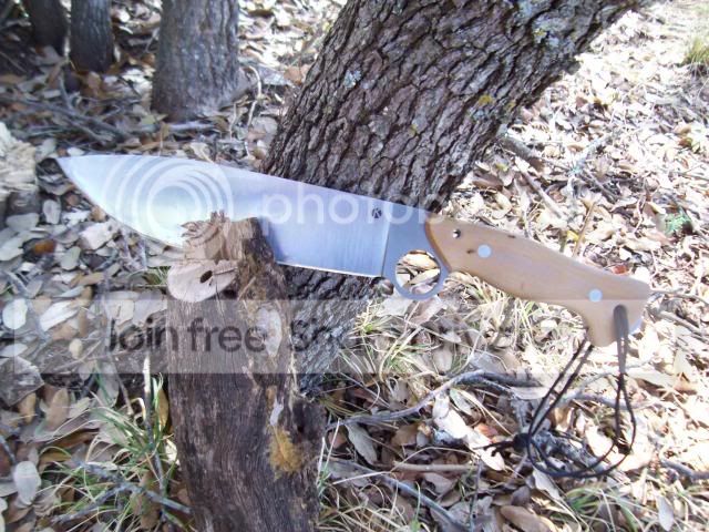

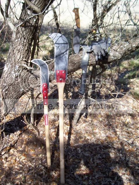

First I introduced him to some other hard working blades here on the place. Big ditch knife, small ditch knife, Gerber brush hook. These three tools get worked out regularly clearing brush here on the place. Normally I will use the brush hooks to cut off at the ground the many, many briers and vines and small trees that cluster at the bases of the live oaks that grow in clusters here on our property. Then I go in with gloved hands, gather up big bundles of the vines and briers, and pull them down out of the trees. The smaller branches which remain low on the trunks of the trees have to be cut back, then. Normally I use a medium sized khuk for this job, but today I used the Survivor.

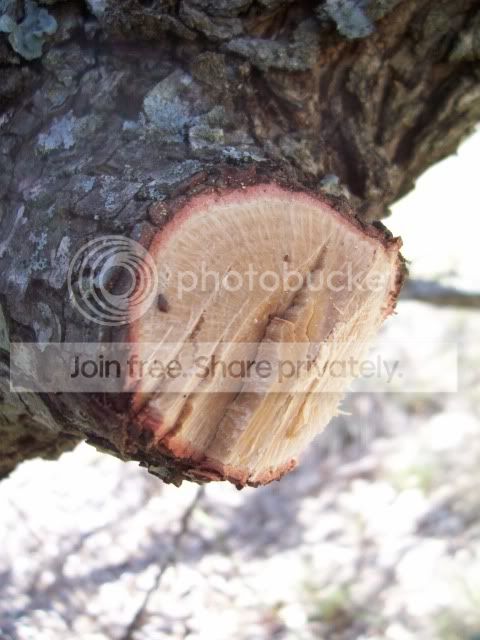

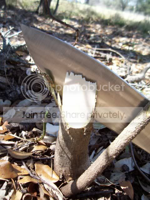

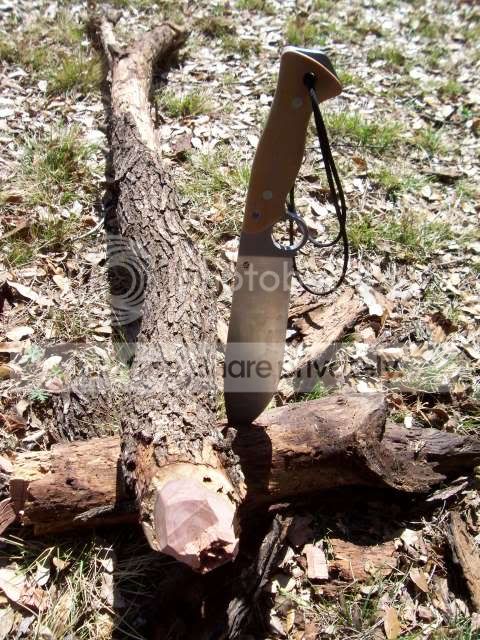

The flatground, wide blade of the Survivor made short work of smaller saplings and small branches.

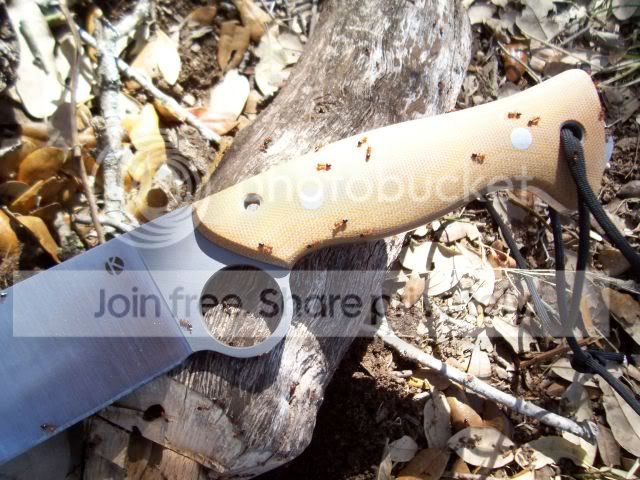

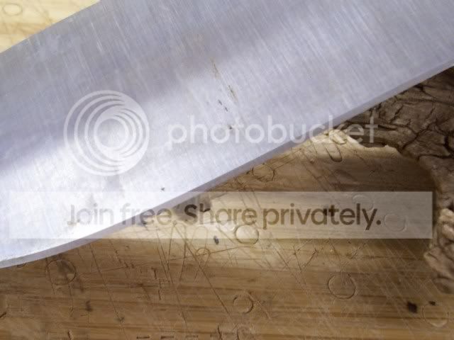

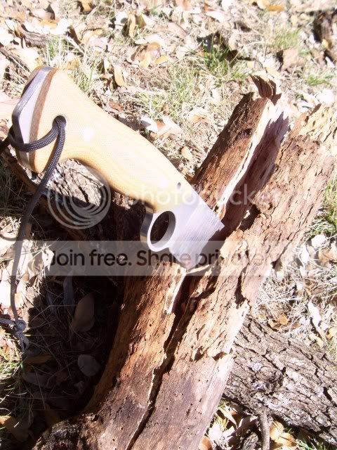

This big blade bites deep and cleanly. I chopped through several pieces of good sized, hard, dead oak branches to see how it would do. Check out the carpenter ants!
More to follow....

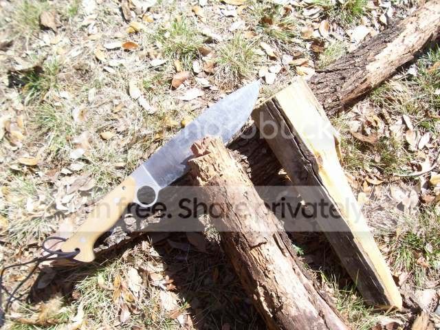

Now something a little bigger, and some batoning.....

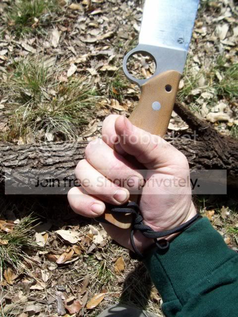

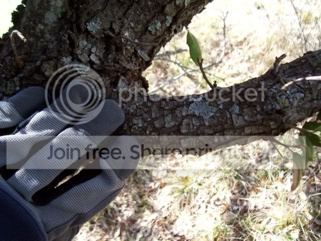

Here is how I hold the knife while chopping. I normally wear gloves, but took them off for the pic.

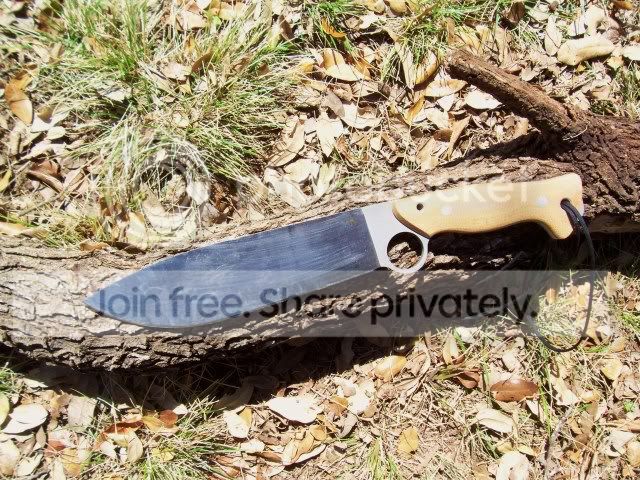

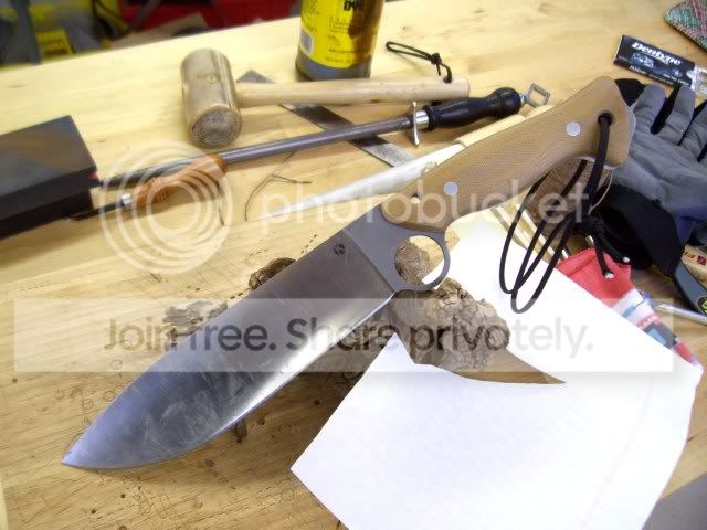

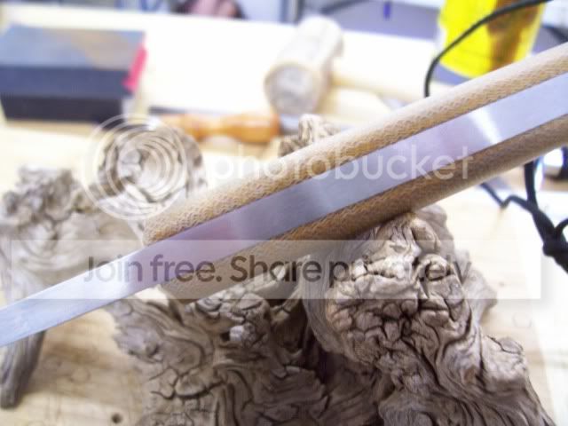

When the work was all done, the blade could still slice paper!
Some observations; first, this is a tough, hard working blade. It kept its edge and sneezed at the hardness of this old, dead oak. The size and shape of the handle, plus the lanyard, allowed a variety of grips. Choking up and using the finger ring made the knife very quick and handy for smaller, less powerful chopping or for cutting up close to the handle.
More to follow....
Andy

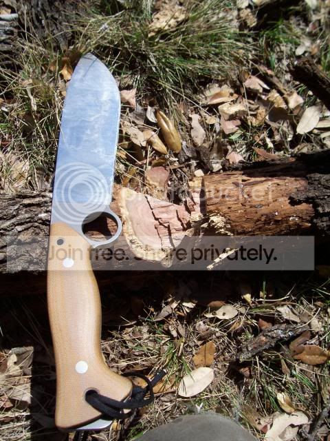

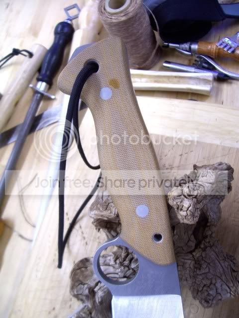

Backing down onto the butt of the handle gave plenty of power for hard chopping. I wore gloves when working with the knife, but without gloves I don't think I would try chopping heavily with my finger through the ring. While it is radiused, the shock of hitting hard transferred painfully to the finger. Without gloves, not using the ring, the handle was comfortable and well formed.
The handle slabs are perfectly fitted and very securely attached to the blade. The handle material is also very tough and resists scratching very well.
I am very happy with this knife. It is a true hard use blade that should last through years and years of work. :thumbup:
