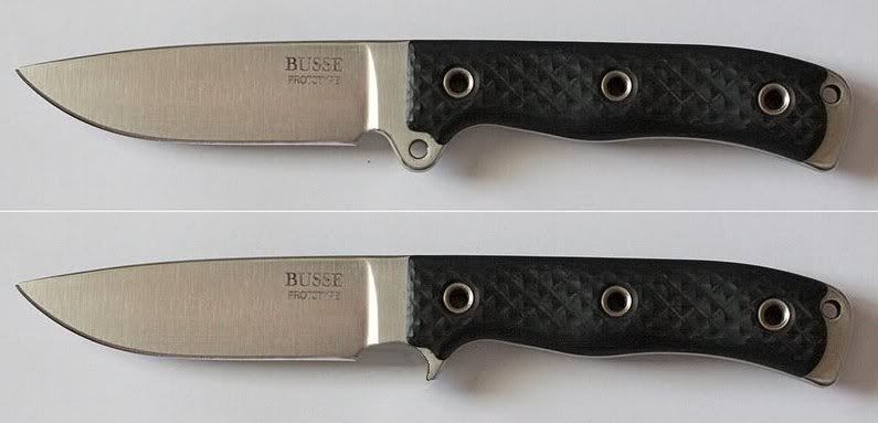

I would be all over the boss streets if it did not have a choil. I really like my game warden but have gotten the choil snagged while cutting things many times. Kind of annoying.
Well.... if it is safe to go with that theory/line of thinking:

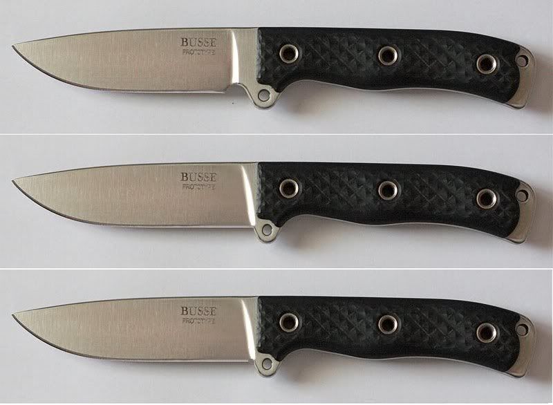

The following - especially the second option without any choil - is what I would prefer (no choil and slightly smaller Talon Hole / Guard = only about 1/2" distance from hand to cutting edge vs. about twice that with current guard end elf choil - also, no snagging):
However, if having to modify an existing boss Street Choil to make it a bit more functional, I would probably recommend something like this (not a great photo-chop, but quick):
In the above modification, you don't loose any of the existing sharpened edge, but rather trade the Talon Hole for a functional choil.
It is not a hard modification. Pretty easy actually.
You can do it with a Dremel. But, I personally use a Drill press with a sanding drum attachment. I prefer the Drill press because I can use a bit better sized drum and more importantly, it allows me to hold the knife with both hands vs. Dremel in one hand and knife in the other.
Holding the knife with both hands offers better control. :thumbup:
After seeing those, I like the elf choil.

I like the last one, I think a tiny choil like that makes sharpening easier and the transition from ricasso and bevel (plunge line) much cleaner. Sharpening a knife without a choil at all can be pretty painful, you can never get into the groove just right without hitting the ricasso. Not a fan of the elf choil either.
That right there is the problem. The elf choil is aesthetically pleasing. So for the sake of something that looks prettier, you sacrifice functionality.
