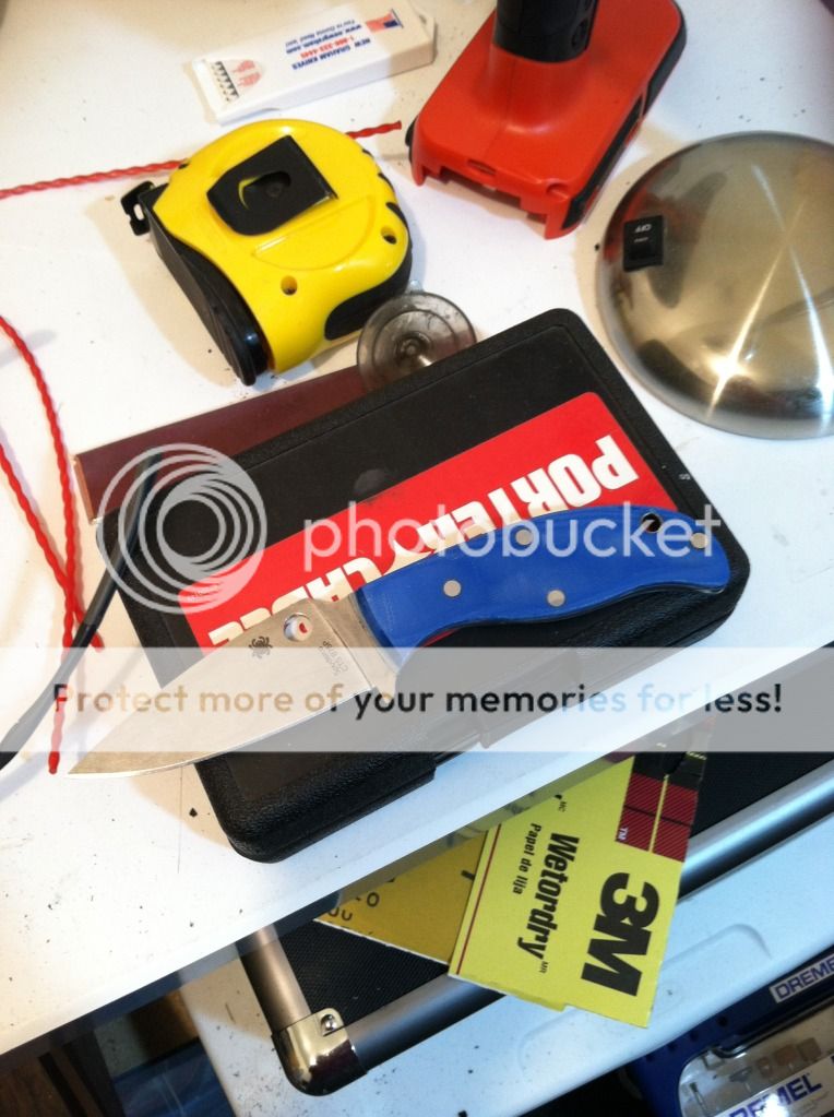

I was thinking the same thing that the glue would be enough to hold the pins in place, i just don't want the handles to be able to move around or anything. Would this be the first time the holes in the blade are .4 in diameter? because from what I've seen 3/8ths seemed to be the accepted width to use.
It seems to have changed on the Elmax. The Cruware has 3/8" holes, the Elmax 0.403" by my calipers. Since I just cordwrap mine, I hadn't noticed.
So does anyone have any input on what the best way to do this would be? either that or point me in the right direction for some .4 in stock, this is my first time making handles for a Mule and i don't want to mess it up. :)

How about you get a corby bolt and a step drill bit? I would think that is the easiest way.
I put some blue pants on my Mule yesterday but need to finish up the odds and ends. All the holes are within spec.
The smaller holes haven't changed since the second Mule, just the four largest.
Interesting. I always use the 3/16" (0.1875") holes and never have measured the larger ones. I find it a bit strange that they would go back to using non-standard sizes for the holes. That was a real issue with MT-01, causing headaches for folks trying to put scales on them. Is there some other reason they changed them? I hate to think it was a random, arbitrary, or accidental change...
I know these aren't large scale production runs, but one of the things that makes the Mule platform so useful is its UNIFORMITY.
