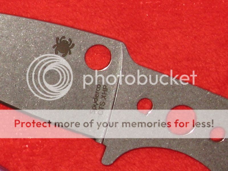

So what do the blemishes look like on the new Mules?
To be honest, not like much of anything. It certainly will not affect the knife in use!

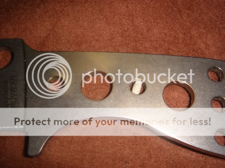

The blemish is only on one side of the knife blade. It is a very minor spot at the back end of the primary grind right on the edge of the plunge line, where there is a slight high spot that appears as a line about 1/16" wide. It is hardly noticeable; You don't even see it unless the light hits it just right, and you can not even feel it. There are certainly other manufacturers out there that would not call it a blemish, but Spyderco's QC is a fw notches higher! Here are a couple pictures which show it as best as I can get it to show up (light colored line in the first pic, dark colored in the second). You can just barely see the line running along the top of where is says "CTS XHP". IMO, these Mules are a steal at $50!!! :thumbup:

^^^ This. Note, only the 3/16" holes have this little notch. It actually won't make a bit of difference once you put handles on. The 1/4" lanyard hole toward the butt and the 4 big 3/8" holes have a bit of "splattered" metal stuck inside of them in one spot where the laser cut ended. If you choose to use these holes (I expect to be using the 1/4" one for a lanyard tube), they will need to be reamed out to ensure the hardware fits without interference. Since the 3/16" holes have the notch instead, I won't have to worry so much about that with my mosaic pins.
My guess is that it has something to with the size of the laser beam and the smallest size of a hole it can cut without overlap in the beam. Obviously it can do a 1/4" hole in one pass without the notch, so 3/16" must be below that tolerance for beam size.
Typically laser cut parts have a small tab of material left at the point where the cut begins and ends. I would guess that the cut is done this way intentionally to avoid having a sharp sprue of material left protruding into the hole that would need to be removed in a secondary operation. The sprue would need to be removed to allow pins or screws to be inserted into the hole. Instead of having to figure out some way to remove a sprue protruding into the hole later they just program the laser to end its cut slightly "outside" of the diameter of the hole so that it burns off the sprue at the end of its cut. I could be wrong, but this seems logical to me.
