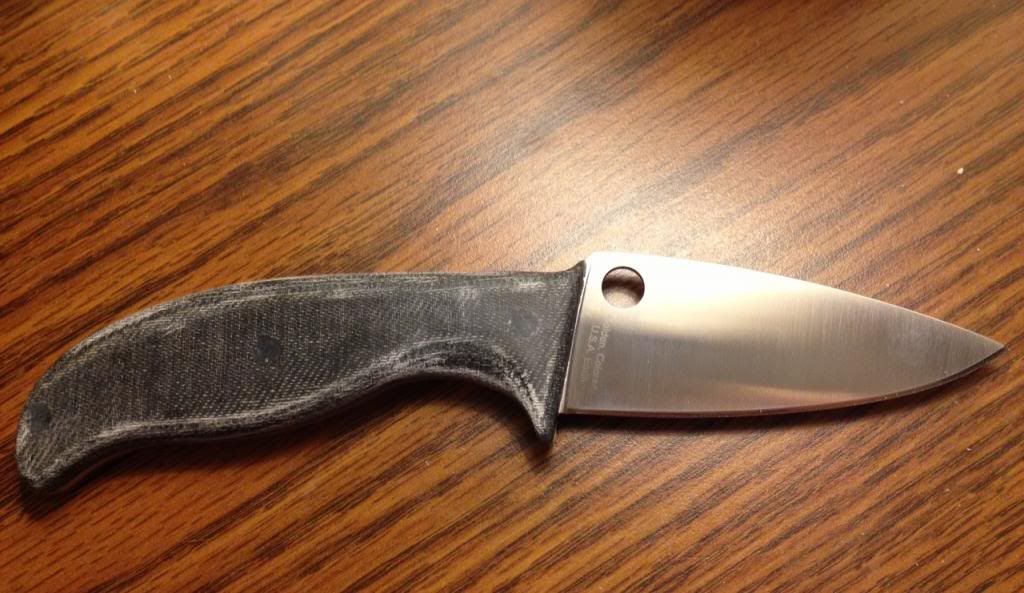

Yep. I'm thinking some of it will come out with a well thought-out set of Micarta scales. Maybe half of it.Wow now that you point it out,yes about 1/8"to the left looking down on the spine.
Finally got my hands on mine today. Brought her home and instantly proceeded to put a Wicked Edge on her.
Couple initial thoughts. The knife I got has about a bend in it--at least 1/8". This is my first Mule Project. Has anyone else seen this? The other observation is that K390 is harder to reprofile than CPM M4! This steel is hard.
