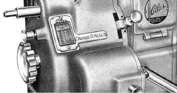

I recently purchased an old Atlas MFC model horizontal mill for certain jobs on folders. Everything looks great on the machine and I have cleaned up most everything...except I cannot remove the MT2 arbor. It has its drawbar but for the life of me I cannot remove the arbor. Any ideas? I think that a couple thous of rust or gunk hold like hell. Thanks.

I don't kave a camera right now but if you go to www.lathes.co.uk/atlasmiller/index.html you may see the exact machine. The second picture down shows the square end of the draw bar. Even if I give it a good rap...nothing happens. Think it is just good and stuck? Perhaps more penetrating oil? Do you think this drawbar bottoms out and loosens the arbor? I don't think so. Hmm?

Man, that looks just like a lathe gear quick change. What a weird mill.

I use a 5 lb lead hammer to loosen and tighten things on my lathe and my Burke, the nice thing about the lead is that it is kind of like a deadblow hammer except moreso, and it will not chip the steel or cast iron. That really loks like a seriously heavy duty mill compared to my little Burke! is that gearbox for spindle speed, feed, or both?
