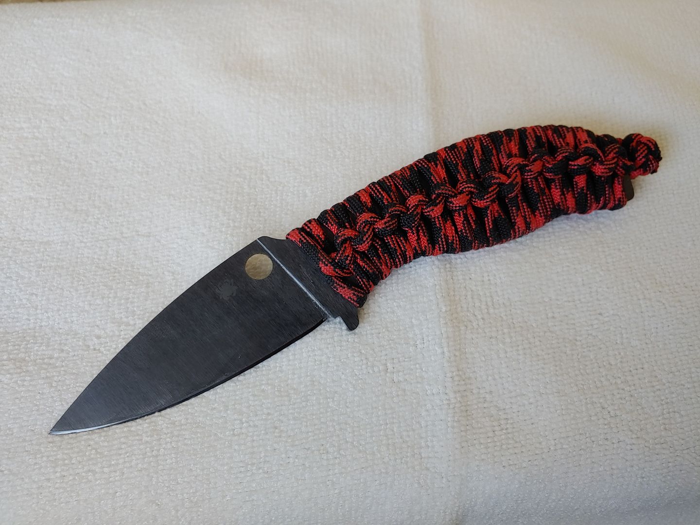

This is interesting stuff. I haven't gotten mine to shaving sharp yet, but I have put an acceptable working edge on freehand on my DMT Diafolds and it has been holding up fantastically well. And just as a little bonus, it fits perfectly in my craptastic homemade kydex sheath.
