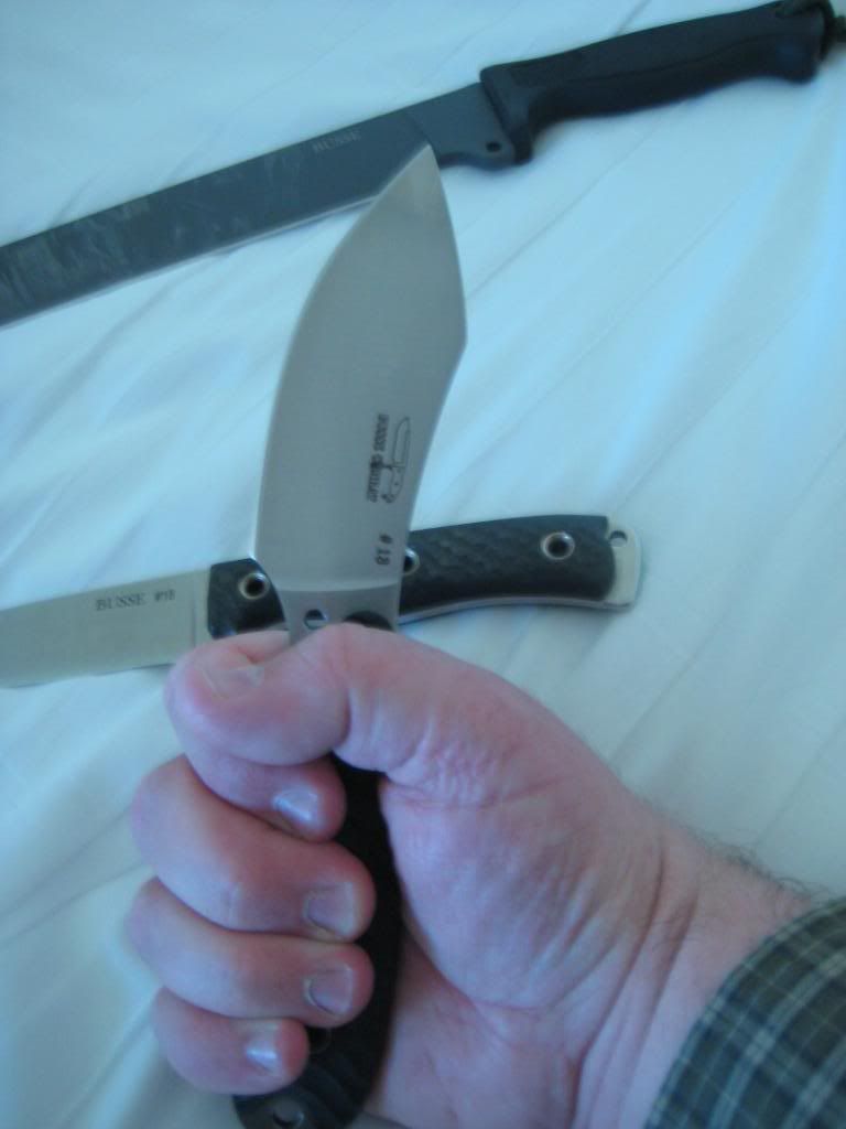

The sar5, active duty and game warden all have the same palm swell to finger swell placement. It's (from my experience with the sar5/active duty) meant to be held where you have your palm over the palm swell and your thumb on the spine over the ricasso. If you do a lot of work in that position, it's great, but if you like to have your hand really close to the guard it puts the swell right under your pinky's metacarpal. Every custom I've handled that took down the palm swell and made the handle a little flatter on the spine was a huge improvement, making the handle immediately more versatile.
take this grip (a pic posted by bigfattyt):
and put your thumb over the spine like this:
and I think you get the intended grip. The other thing to consider is that the placement of the palm swell on the MUK puts your hand at the same distance from the edge as it would be on a normal gaurded large choil knife. Look at this ratmandu's palm swell, and look at the distance between the edge and the swell. That distance is identical between the MUK and the Ratmandu, even though one has a guard. Your hand is meant to be in the same position as the Ratmandu, but without a guard in between.

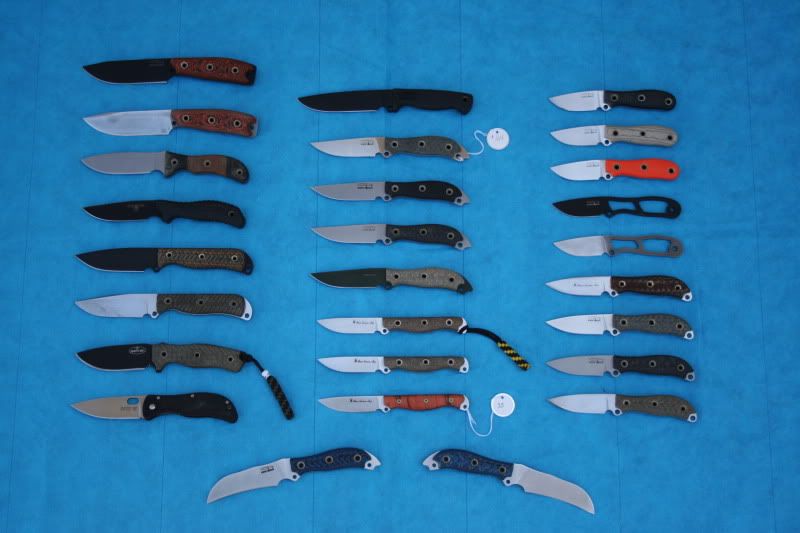

This is a good image for showing how the palm swell placement is consistent across many models. If theres going to be a palm swell, it'll place your hand about 1/2" away from the gaurd, in a position that puts your thumb right at the start of the edge.
I'd be interested in hearing jerry's take on the MUK handle. It seems like it takes the pork belly skinner and makes everything more fluid, removing the bumps and extra positions, leaving a smooth transition betwen grips.
