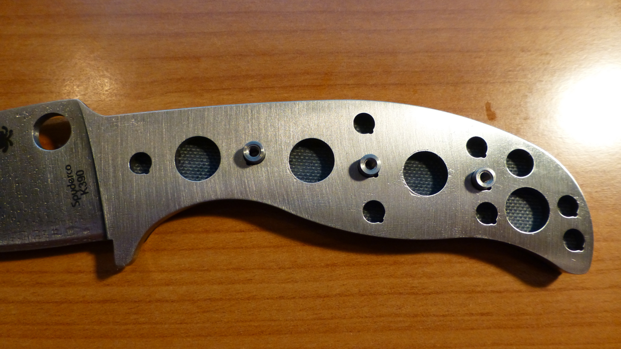

Does anyone know what size pins I need to add some handles to a Mule? I don't have a Mule at the moment to measure myself. Thanks.
Which Mule and which holes are you planning to use? Some of the hole sizes have changed over the years.
MT17, the one I just picked up today. I was hoping to get some wood here quickly, but if the holes have changed size over the years, I may be stuck in wait-for-it-to-arrive mode.
Here are the holes on the MT17 and the pin locations used by the Halpern Titanium G10 scales:
P1060714_zps8087bef0.png~original

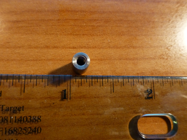

I don't have a caliper, but I'm 99% sure the small pin holes take 3/16" pins:
P1060716_zps49f086a3.png~original
The lanyard hole measures 0.25" and has not changed. The large holes measure 0.375" on the MT16, 0.407" on the 15 and seems to vary a few thousandths on some of the others. The smallest holes measure 0.192" on the 16 and 15, and seem to be consistent except for the 52100 MT01P which were smaller. I don't have my 17s in hand yet, but if you plan to use the small holes for pins I think you'll be safe to order your pin stock now.
