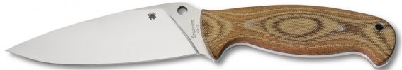

Here's what I'm considering. The HT handles leave less than a mm of tang exposed. Would come around the bottom of the finger groove to the same tolerances. Still debating...

That's what I'm planning to do. I will also flare the end of the handle scales slightly instead of flat, or even tapering in, to serve the same purpose.

I'll probably grind it down a bit on at least one of my Mules when I come around to putting my own grip on it. I suspect I'll leave slightly more of it then what Eagle Scout shows on his picture, but it reainst to be seen. I think it's unnecessarily big, but then again I grew up with Moras without any kind of guard. :)
That's a nice look Eagle Scout Eagle Scout
Thanks for sharing. Now I gotta figure out a way to re-grind that area without inducing too much heat.
Thanks. Closest I could find to something possible for the Mule based on their other products.
A Dremel with a sanding drum will do it. Draw the shape in marker and tape off the rest of the knife. Clamp the blade down to the bench and go SLOW.
