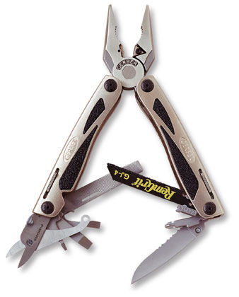

I have been wanting one of these since I saw them on Equipped to survive:
http://www.equipped.com/shot00.htm
Well they have finally started arriving at knife dealers. The Knifecenter has them in stock:
http://store.knifecenter.com/pgi-Product%20Spec?GB8239,
They are now called the Gerber legend. I ordered one today and cant wait to get it into my hands. A review will be forthcoming. These look like a real winner, but I will let you all know.

I just got in a dozen of them today (yes, they're all spoken for and have shipped- sorry) and the sample I kept is very encouraging. It's lighter than my SuperTool, thicker and curvier too. Tools have that Gerber slickery beadblast. Tools all seem to work well so far- I haven't twisted any of the screwdrivers off like I did to an older Gerber. The one thing I don't like about it is that it lacks a ruler like the ST. Best thing about it? SPRING-LOADED pliers!!! Another great feature is the wire cutter- that little triangle carbide cutter can be rotated 3 times, and then, after wrecking all 3 sides you just replace it- ingenious! It all comes with the ubiquitous Gerber nylon/velcro sheath, and a T8 L Key to loosen/tighten tools (they all ship way too tight for my liking). The locks work well, and the replaceable 1/4" jigsaw blade is a good feature when you end up cutting more than one type of material (altho I'll let the Dewalt handle the tough stuff). It comes with a RemGrit jigsaw blade. One other "feature" that isn't as endearing is the blade- which, like the scissors is one-hand opening, but it's a COMBO edge- yuck- especially on such a short blade.
Joe- while the scissors are SHORT, the fact that they are spring-loaded as well, makes them really easy to use- very similar to the Micra's.
That's the short review- I think a few of my customers will be posting more once they receive them. In essence- I like it!

I got mine today. I am a little dissapointed to be honest. Of course I really had high expectations of this multi-tool. Gerber came really close with this one.
All tools open from the outside
All tools open independantly (no clumping)
All tools lock
replaceable tungsten carbide cutter
replaceable jigsaw blade
spring loaded pliers
handles dont "bite" when using the pliers
partially serrated blade (would rather have one of each)
tool is a little bigger than I would like
the sheath sucks! Way too big. reminds me of those old flap style holsters for pistols
The screwdrivers are too short
The handles are too widely spaced when using the pliers. I have medium sized hands and the handles are almost too far apart to get a good grip on when using the pliers.
I am not sure why, other than looks, Gerber used the black rubber inserts. They contribute nothing to the ergonomics of the handle. The handles are so thick and far apart that the inserts don't add much to the feel.
Overall I like the multi-tool. There are a few things I would change. It has alot to offer and is definately an improvement over previous Gerber multitools. This one has alot of good features, but it could be alot better.

Dennis - thanks for sharing your thoughts on the tool. About the drivers being too short - looks a lot to me like the Phillips driver will accept that coupler that Gerber sold along with the Multi-Locks. I guess you can slide one on there and put a driver bit in there to gain extra length? Wonder if they'll offer the coupler and extra bits along with the Legend someday. that would increase its versatility in the driver department.
