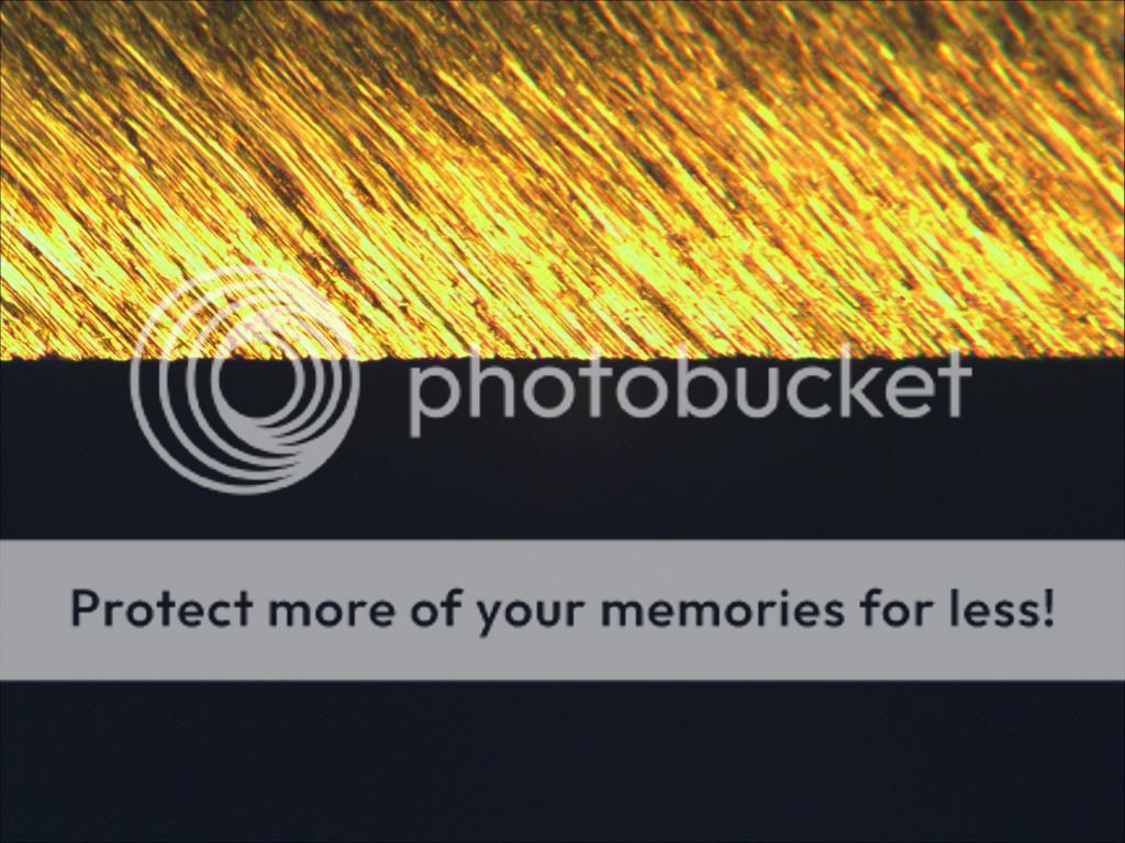

Here's what I've come up with, all of the pics show 1095 steel worked on a King 1200 grit waterstone. The first is at 120x, the second two are taken at 500x, the fourth is taken at 1000x. The first two are using the stone with frequent rinsing, no mud or slurry allowed to form - it looks very much like the grind pattern from a whetstone. The third and fourth show an edge that was worked with a fairly rich slurry and finished with some backhoning on same. There is a huge difference in how the abrasive is interacting with the steel, not just a minor reflectance issue. Consider, the two middle pics are at the same scale. Not only do the individual grind tracks appear different, the entire scratch pattern is different. The edge quality is very different as well, with the slurry-worked edge exhibiting more refined cutting characteristics by a clear margin.
Not sure if this will help you any with your 4000K. All I can say on the subject is that when it comes to some brands of waterstone, the way the slurry is managed can have a huge effect on edge quality and it can take a month or more to develop an instinctive understanding of how they work. I'm used to King and Norton, I always finish with some edge trailing strokes when using these stones, especially the polishing grade stones.

Wow, nice microscope images! :)
In the last and final image, what's the magnfication, and what is the approximate scale for the image?
I'm also curious if you are using bright-field or dark-field illumination?

Hah, hah, I was waiting for you to bust me on the scale! These pics were taken before I had a scale I could apply in the software package, and the tablet that runs that software (and the camera for the microscope) is isolated from the network and the web. Add to that I cannot find my thumbdrive, so I put them up with no scale - my apologies. As a rough guess, the image area is about 70 microns across.
The magnification for the last image, taking into account the digital boost from the camera is supposedly 1600x. In reality, its only 1000x (or so) of quality magnification, as the wavelength of light prevents higher magnification optically. If I can move the pic around and get a precise scale applied I'll be sure to update it.
Illumination is EPI, so the objective acts as the condenser, light source is directly above the item.
