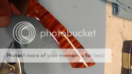

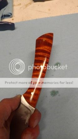

Are you trying to make aqua fortis? There are many recipes for that on line. I would second using Fiebings Leather dye. You can mix different colors to get the results you want. This is a 50/50 mix of light brown and light tan.
Dang, that's pretty. Exactly what I had in mind. It seems like the Feibings is getting more votes than the other approaches--and it's easier than messing with acids. Appreciate the advice. Maple is such a classic look.
