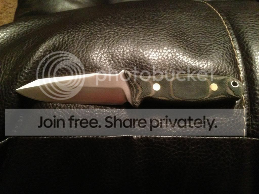

Try this stuff in the pic below. I get it from Menards. Its the same epoxy thats used on table tops. Its very durable, crystal clear, and is reasonably hard(will not crack or chip if impacted, like fiberglass resin will). I used it to make micarta using green and tan canvas. I think it turned out quite nice (see bottom pic).
