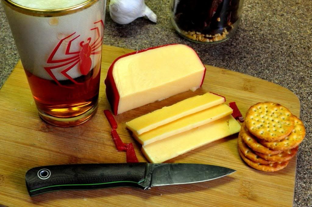

Well...in the last couple of weeks, time has really flown by for me. I wish now that I had taken more detailed pics of this knife before the patina got o dark. It is my fourth HB and third with a high grind, so at first I didn't put a lot of thought into it, I was just trying to develop some protection for the steel, for working out in a high humidity environment. Most of the time I have been using the knife in the kitchen and in the field, I was more focused on activities to come than what I was doing at the time. Yet even though I wasn't exactly conscious of it, over time little things seeped into the morass of thoughts in my head. Just little things really, but still nice touches. It's 5/32 but slices as well as any of the 1/8 versions I've had, and a good bit better than the scandi I had when it comes to some things. Then I noticed it felt different to my fingers when I cleaned the blade. Then it dawned on me, that all of the ones I have had were older ones. I had to put a straight on this one just to see if it was a convex or full flat grind. Convex it is, but man it's the shallowest convex I've ever used, and damn I love how it slices. I also like the more oval shape of the handle compared to some of the other more rounded handles, it gives me more leverage and more control in various grips. The one down side of that is the Hiking Buddy sheath I have was used for years for my first HB and is this one fits a bit loosely in it. The handle finish is amazing. Not one hot spot after a good bit of notching, carving, whittling, but the contours still give me a secure purchase on the handle. I feared I would end up wishing it was a tapered tang, but I really like the swell of the pommel on this one, and the balance is close enough to neutral, being just a bit handle heavy, that it doesn't cause any wrist fatigue. Not the first time I've noted this, but I really like how the maker's mark is still clear even after a patina and heavy use. Good show guys, this thing is really sweet!

Lol, you're quite welcome :) This is my second in 5/32, but the first was an original full tang version which was handle heavy enough to make me think I needed a tapered tang. But I am very pleased with how this one feels. For me to be as happy with a tapered tang, I think the handle would need to be built out more. Considering I plan to use this knife in some fire starting classes for some local scouts, the SFT tang is likely the better option anyway.

I know what you mean about flat and convex grinds. I've owned a few Fiddlebacks that I swore were flat grinds. Those are nice treats IMO. They slice like nobody's business, they feather stick a little easier and they bite into wood significantly better than a deeper convex of the same variant.
I really like the shot of the maker's mark resting in the patina. It makes it look like a hiking buddy from the 1800s. Nice shot man.

I appreciate the observation on the grind. I have had the same feeling on some of my knives. Andy's convex treatment is much more subtle than say a Bark River convex. I know that a lot of that optical illusion is related to the thickness of the steel and the height of the grind. Since Andy uses thinner blade stock on average than Bark River, his grinds appear more flat than convex, even though that is not true.
I like your comment about the older sheath feeling looser due to the narrower oval shape of the new one versus the more rounded shape of the old ones. I had that same experience when I used my Hiking Buddy sheath to carry the Patch knife. Even though both knives have exactly the same circumference at the palm swell, the sheath had taken a set to the wider handle on the HB, so the narrower Patch handle didn't feel as secure. I ended up ordering a new Rick Lowe sheath for the Patch. In general, I have found that universal sheaths are not universal any more once they have been mated to a particular knife for a while.
It goes without saying that your photos are fantastic. You manage to capture a 3D quality in every shot. Your choice of background color and texture always shows off the knife very well. The lime green pinstripe really stands out more after the patina has set in. Beautiful knife and photos!

Andy's grinds have always seemed flatter to me than a lot of other maker's convex grinds, and I have always really liked that about his work. But this one really got my attention even swamped. I really had to put a straight edge on it to be certain, and even on this narrow blade the straight edge barely rocks. That's impressive for such a narrow blade. Still convex for the strength, but flat enough that it is an awesome slicer. It couldn't get any more perfect fro me than that.
Yeah that sheath was used for a bout three years for a Hiking Buddy I bought in '09 I believe. It was fatter and rounder than this one, on full tang 1/8. While I soon got over the scandi grind, that handle was always comfortable in long term use. That said, the more detailed contouring on this one is more comfortable to me is use, and gives me more control of the edge.
Thank you for your complements man! I saw early on that doing these knives justice in photos would be challenging. Nice to know I am succeeding in my attempts at doing so. I'm glad you like the pics!
Mist, what did you use to get such a deep blue patina?
Well, I used the knife to cut vegetables and fruits with several times. Then one day I made a sandwich and used the knife to slice the tomato and spread the mustard...then looked at it...spread the mustard more in such a way as to even the coating on the blade, then just laid it down. I got distracted and forgot and it sat like that for about four or five hours. Then I cleaned it back up. The thing with using mustard for a patina is that the reaction needs oxygen, so the thinner you spread the mustard, and the longer you leave it, the deeper and darker the patina.

Hey, no problem man. Yeah, I am in a very high humidity environment and I just really wanted to get the O-1 a good layer of patina in place. Patinas to wear off some with heavy use.
