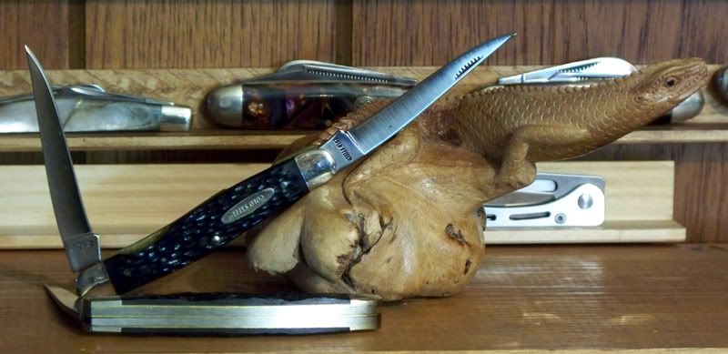

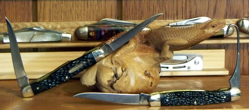

Here is the Cold Steel Muskrat, made with Carbon V and sadly out of production. It is a two spring knife and is seen with it's brother, the bird knife which subs a guthook for the second blade. This Muskrat get a good bit of pocket time as one of my "social setting" knives.

Those Cold Steels are nice Absintheur. I'de like to see that same shot about 10 feet away to see the rest of your collection.

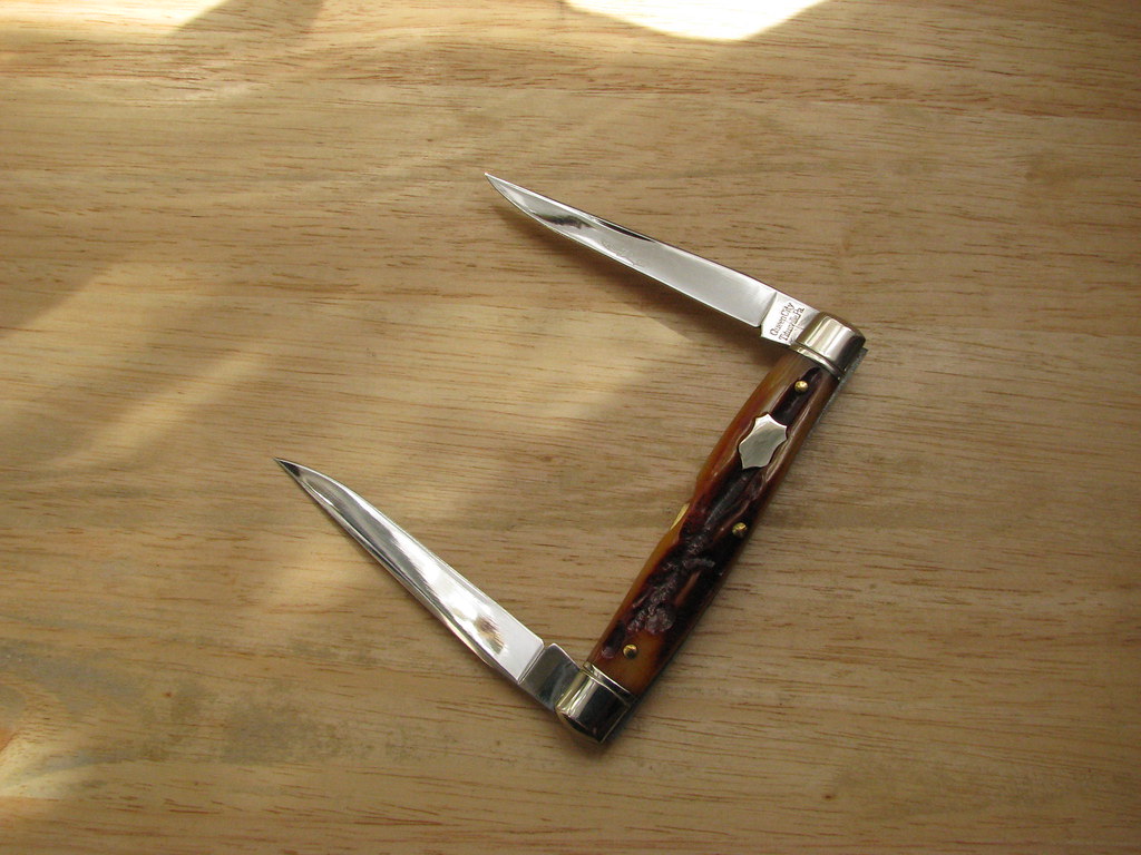

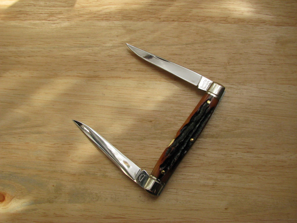

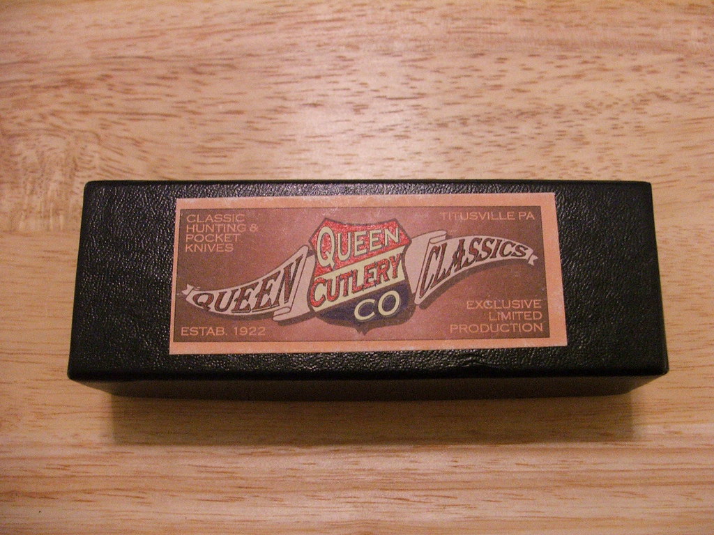

Here are some pictures of that Queen Classics knife in red stag, along with its original box:
