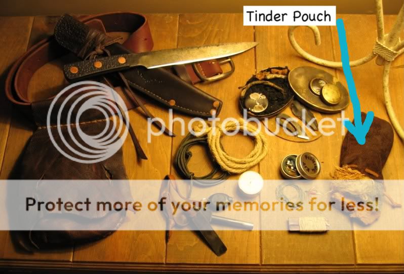

My tinder pouch contains:
-jute
-fatwood
-steel wool
-cedar bark
-true tinger fungus
I keep it all mixed together in a small leather bag. My char stays with my Firepouch Tin.

I gotta say, everytime I see your fire kit I love it more...:thumbup::thumbup:
