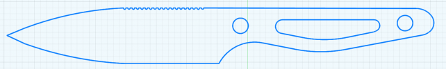

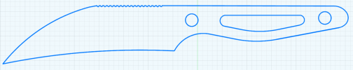

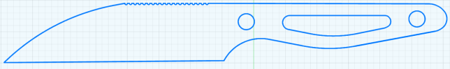

A few of you have tried blades I cut by hand like these ones, and have said that you liked them. I am going to be making more like these, in .100" AEB-L first (just over 3/32"), and possibly other steels and thicknesses down the road. If they are successful in the first run, MagnaCut is a distinct possibility, and would seem like the logical step.
I have yet to come up with a name for this series, other than "knuckle clearance large necker". 🤷‍♂️ This new version is slightly slimmer than most of those originals, and knuckle clearance is no longer a defining theme. The blades are still quite tall, at nearly an inch of blade height at the widest point, so they will still be excellent slicers.
ETA: Given their lightness, speed and ability to be called forth at a whim, these will be the Mustelid Scout Series, named for the fleetfooted family of animals, thanks to the great suggestion of Hurrul Hurrul .
The design is 7" overall with 3.48" blades, a heavily skeletonized handle and two .255" pin holes. They all have the exact same handle and jimping, with only the blade profiles differing. Here are the different flavors:
Wharncliffe - Otter Scout
Bowie - Marten Scout
Drop Point - Polecat Scout
