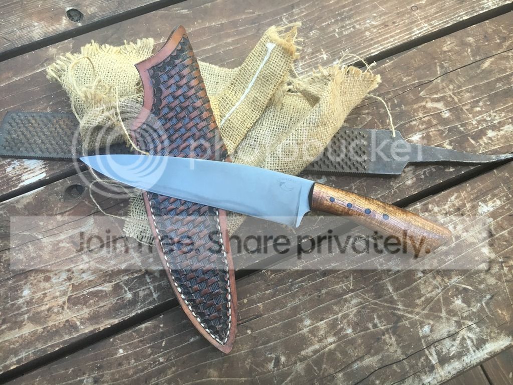

Before I get into talking about the knife, I want to give a big shout out and thank you to John Doyle. Before I started this project, John was on the phone with me for over an hour, patiently describing how to taper a tang and talking me through many other techniques. Then when Aldo was out of stock of the steel I needed, he sent me a piece of his steel. On top of that, he also dealt with my frantic phone call when the blade warped during HT and talked me through straightening it out. I can't thank him enough for all the help, he has really helped me to grow as a knife maker. I hope to meet him in person some day and shake his hand and say thank you!
About the knife- I was contacted by someone who puts on the local Friends of the NRA banquet dinner and asked if I'd be willing to donate a bowie to be put in the live auction... and this is the result. I'm my own worst critique, I wish the pin holes would have turned out better and the hamon didn't turn out well (I think I applied the clay too thick, because I know the entire edge hardened) and my makers mark didn't turn out very pronounced. I could critique it all day, but I learned alot in the process of making this knife! It has been a humbling project!

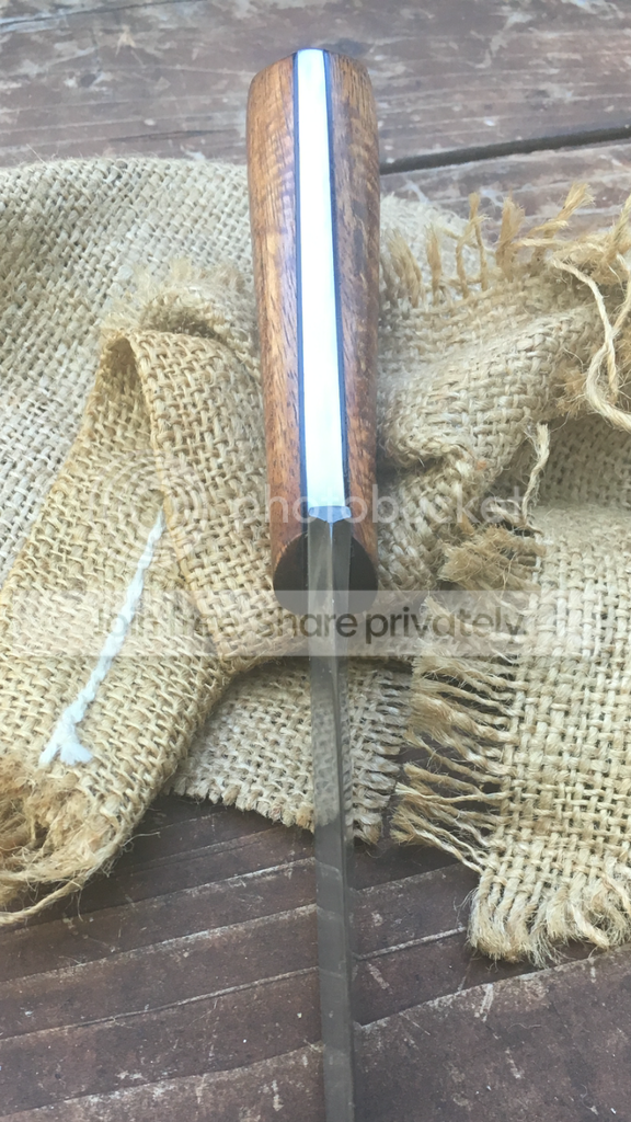

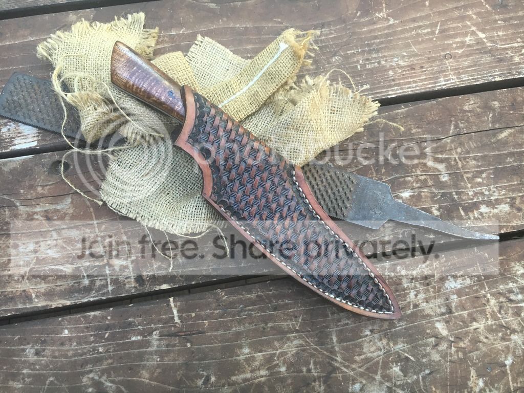

The blade is 1/4th inch 1075, with a tapered tang and distal tapered blade- it balances wonderfully right at the ricasso. The overall length is just over 11.5 inches... it was longer until it slipped out of my vice and in an an attempt to catch it, I threw it into the shop floor tip first. The handle is Hawaiian Koa with black G10 liners and carbon fiber pins. The sheath is a Paul Long inspired (obviously his work is alot nicer than mine) butterfly sheath made from 9oz Oak Double Shoulders. I went around the yard and chopped sticks with it and then took it in the kitchen and prepared dinner with it... is feels very comfortable in hand and was shaving sharp after I played around with it.
Comments, questions and critiques welcome!
Damn Nic, you are getting the hang of this! Very nice looking knife and sheath. Your hard work is really paying off. If you're going to pick someone to be in your corner on a build, John is a good choice. If I was going to get nit picky (and you know I am) I'd just say try to make the handle pins follow the same arc as the handle. And, watch your borders when sanding the edges of your sheath. Try to keep them an even distance all the way around. Also, the use of an edge beveler to knock off the square edges will give the sheath a more finished look. Keep up the great work.
Yeah good looking knife, I'm a sucker for blades with arcing spines like that. Only thing I can nit pick on has already been nit picked. The pins and a gentle arc the fallows the center of the handle and generally at least for me I space them an even distance across the entire handle. I like a pin in the butt of the handle becaus if it gets dropped that's most likely where it will impact. I like to see a drastic tapered tang, some of my knives I taper down the where the tang almost disappears it's so thin. But other than that I think you did a wonderful job.

Thanks Marc! I know, the border on the sheath didn't turn out how I wanted it to. Thank you for the feedback!!
Thanks JT! I'll do the pins different next time and taper the tang more.
