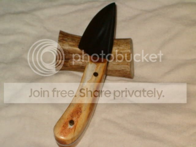

My 1st crude attempt at small blade
Feb 11, 2005
582

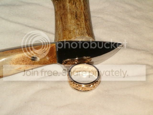

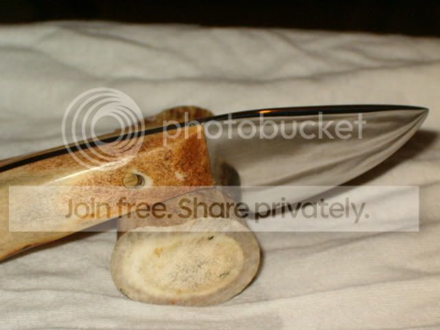

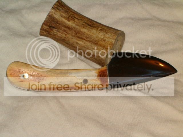

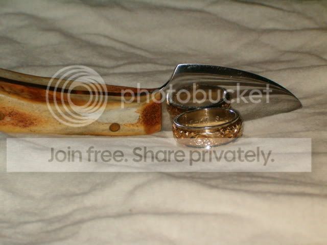

A little skinner/back up blade made from a strip cut off a worn out sawmill ripsaw blade in the early 60's, when the saw blade was made originally I don't know.
I mentioned a while back to my dad that I was considering making a knife, and he went to his shop and pulled out these strips he had kept from before I was born, that he was gonna use to make a knife, and never got around to it, so I consider this his knife as much as mine.
The handle is from a shed whitetail antler I found last year. Overall length is 4 3/4", blade is 2". The grind is convex (that's a story by itself), and shaving sharp. The scales are a bit crude, like the rest of the knife, but it feels good in hand, and holds a very nice edge. I boogered up one of the pin holes, and the scales aren't a dead even match, but I am glad to have it.
Tools used: 4" angle grinder, 5" orbital sander, drill, dremel, and much, much sandpaper.
Comments are welcome, but go easy on a noob.

In fact, the only flaw I can find is the pins, so I'm going to give you some unsolicited advice.
After you're done with the blade and before you add the scales, drill your pin holes where you want them in the steel tang.
Then tape your scales together real good so they line up, and shape the front of them. Then, attach one scale, and wait until the glue/epoxy dries up(24 hours) then, using the holes that are already in the tang as guides, drill the tang holes through the one scale that you just put on.
Then, epoxy on the other scale, making sure the fronts line up since they've already been shaped. When the epoxy is dry turn the knife over, and use the holes that are already in the first scale as guides to drill through the second scale.
I hope that makes sense. Essentially you will have perfectly lined up pin holes if you do it this way, and they will be even better if you have a drill press, but they will still come out nice if you are doing it freehand.

You do all final shaping after the scales are attached. The only pre-shaping you do is on the front, because it is hard to shape whatever roundness, etc. on the front without scratching the blade.
The rest of the scale can be as crude as you want, because you want to do all the other shaping after they are attached so they come out nice and even. You don't want to pre-shape your scales too closely and end up that the scale is smaller than the tang.
by sanding some antler, saving the dust. Mix the superglue and dust and use it to repair the hole. After glue dries, sand the patch level with the rest of the scale, then buff...
Saw blade steel typically runs between .60 and .80 in carbon, with some Ni and Cr thrown in, makes a tough blade....
