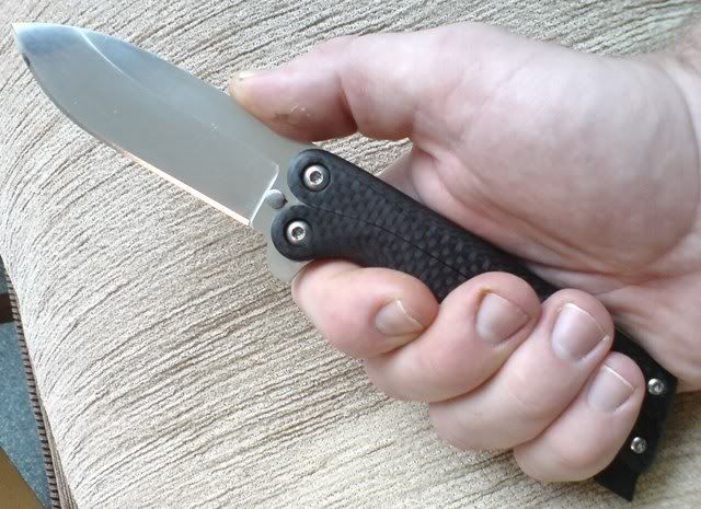

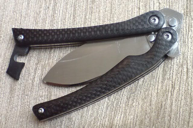

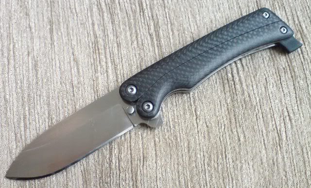

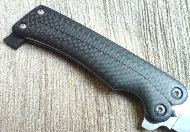

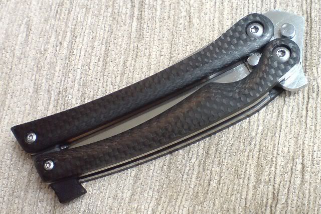

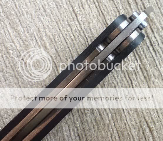

I guess I should have posted this in the Knife Maker's Gallery. But that didn't work, so I hope it's ok I post it here...

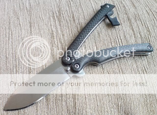

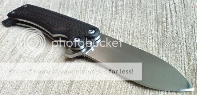

I have now finished my 2nd knife!
But before we go into details, I better highlight that even if this is only my 2nd knife, I have a mechanical engineering background- which for sure helped in this project. Thought that I should mention that- just in case you think I am a troll- which I am not.
I designed and made what I call a Utility Balisong, since I like the concept of the Balisong. Very safe and will not close on you fingers when you use it (unlike one factory folder I have). But this knife looks more like an ordinary folder. Now I have to learn some basic safe flipping.
The only power tools I have used are a $50 mini-bench drill (made in China) and a Dremmel machine. The blade was grinded by hand.
The blade is 3.5 long, .13 thick and made of Talonite. The liners are made of .10 thick titanium. The handle material is carbon fiber. As you can see of the below pictures, the locking latch is not of the traditional design and therefore gives you several options how you can manipulate the latch and lock the knife. Its a sturdy design and the weight is 6.2 oz (183 grams).
I also would like to mention that I feel Talonite is much easier to work with, than the first impression I got when reading about it on Internet.
Here are some pictures. Not the best quality since I took the pictures with my mobile phone- but should be ok.
What do you think? I must admit that I am rather satisfied with the result. One thing is for sure, this wouldnt be possible without BladeForums.com and all your contributions here! I have been lurking around here for a while reading up on knife making. Thank you!!!
