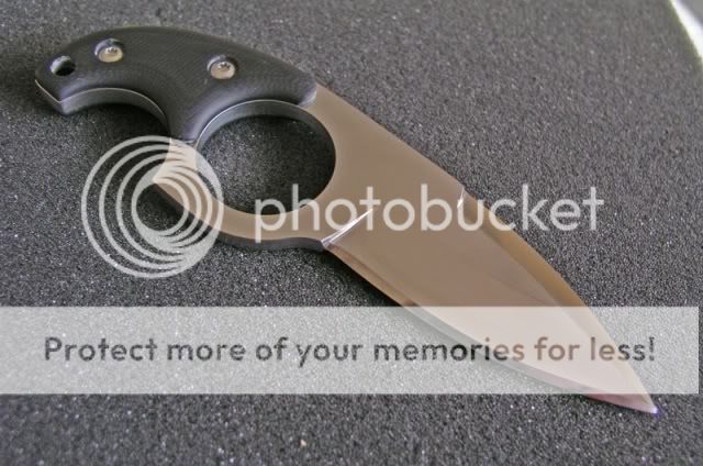

Hi dialex,
That would be this one:
But after that one was done, I realized that a similar design was already around. :grumpy:
I probably should add that this one I made 2- 3 years ago.

Whoa! Very cool looking knife. Indeed, there are many LaGriffe style knives, but yours, just like your balisong, bear its own personality. I like the design a lot and the manufacturing is top notch. :thumbup:
Thank you for answering my request and I'm looking forward to seeing your future creations. :)

You're second knife is much better then mine! What method did you use to shape and finish the carbonfiber and what looks like g10?
Also how did you countersink and get the correct depth and angle with the dremel? I have a simmilar toolset, and I would appreciate any advice!
Hi physh,
On the first knife (the one with the finger hole) I shaped the G10 using my Dremel with a sanding band. The good thing is that it’s quick. The bad thing is that it gets messy and you have to be careful, since the sanding bands takes off material very fast.
So for my 2nd knife, the utility balisong, I just used sandpaper and shaped the carbon fiber handles by hand.
Then I used an End Mill in my mini-bench drill to countersink the holes for the screws- not the dremel. I hope that helps.
I do agree. Even the LaGriffe isn't the original incarnation of the knife style.
Nice work on both of them!
When is your next knife due to be done? :thumbup:
physh: I ended with 1000 grit. Or was it 600... Not sure now...
