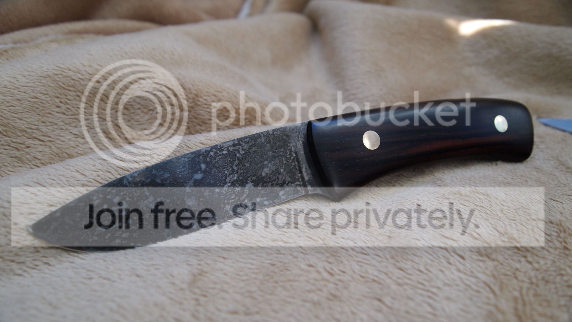

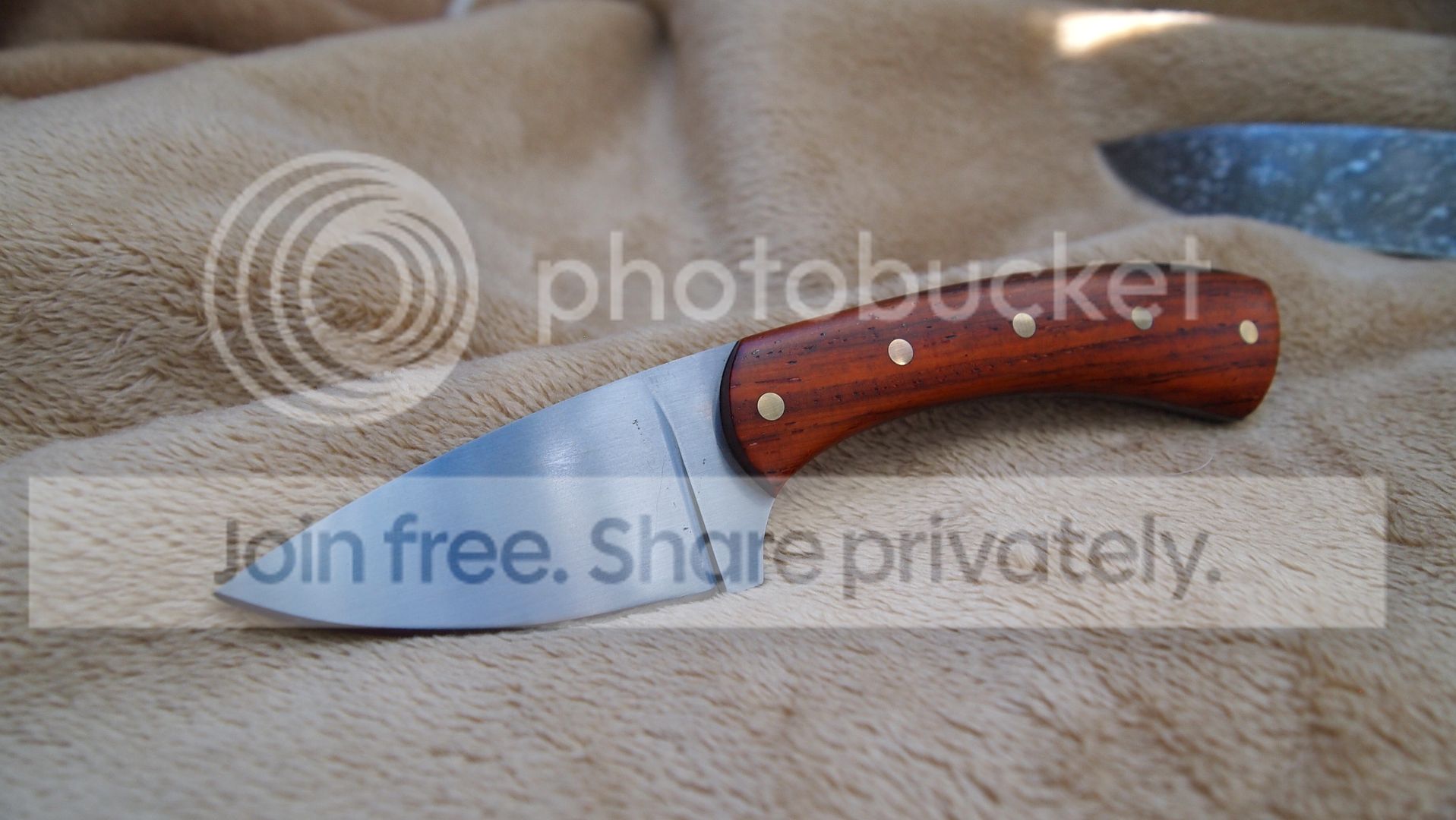

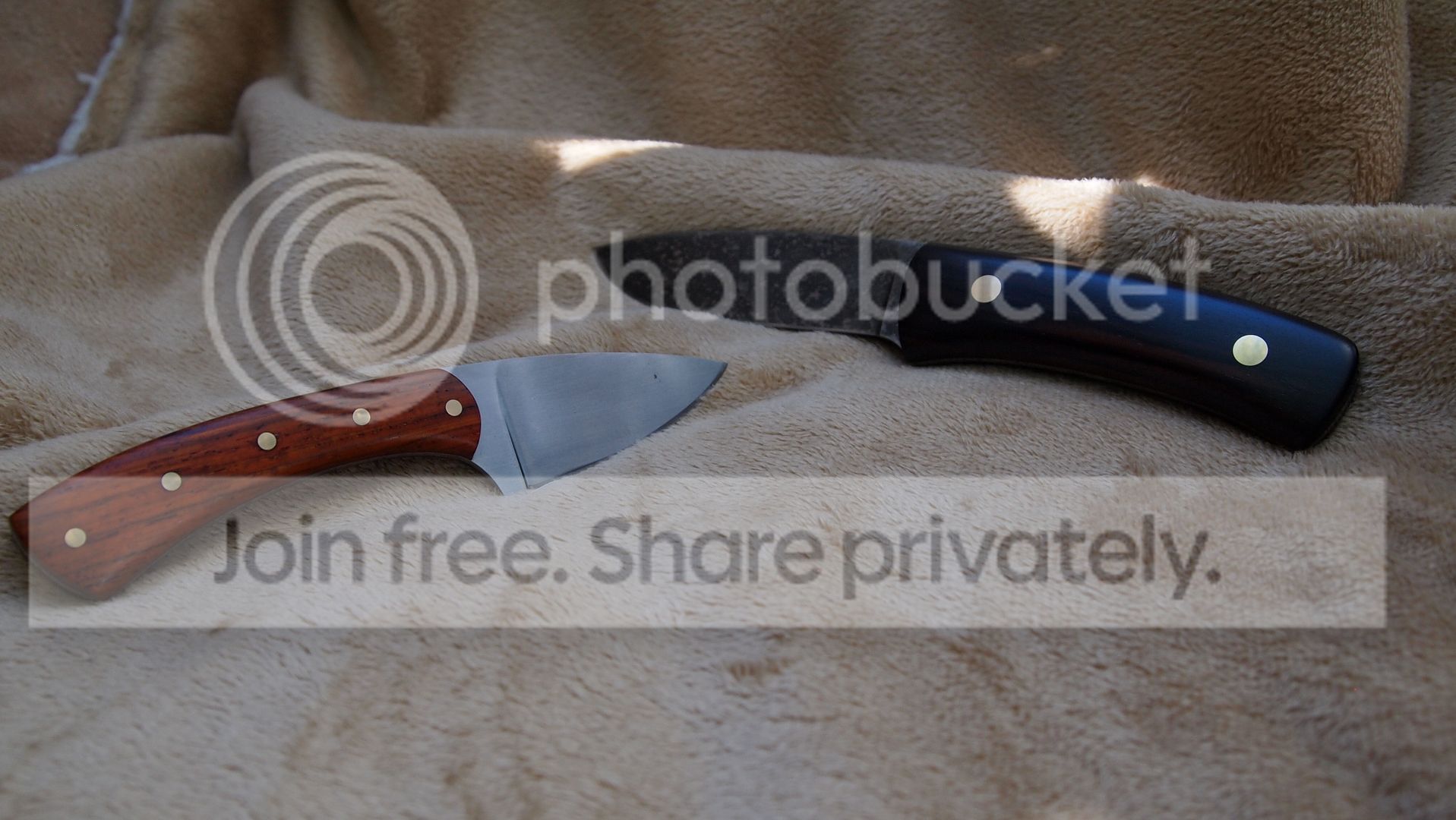

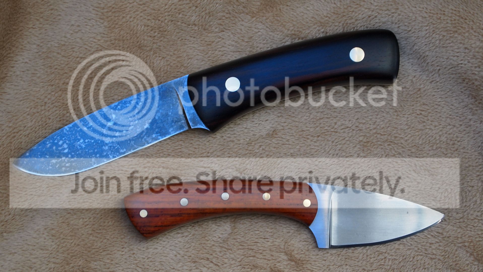

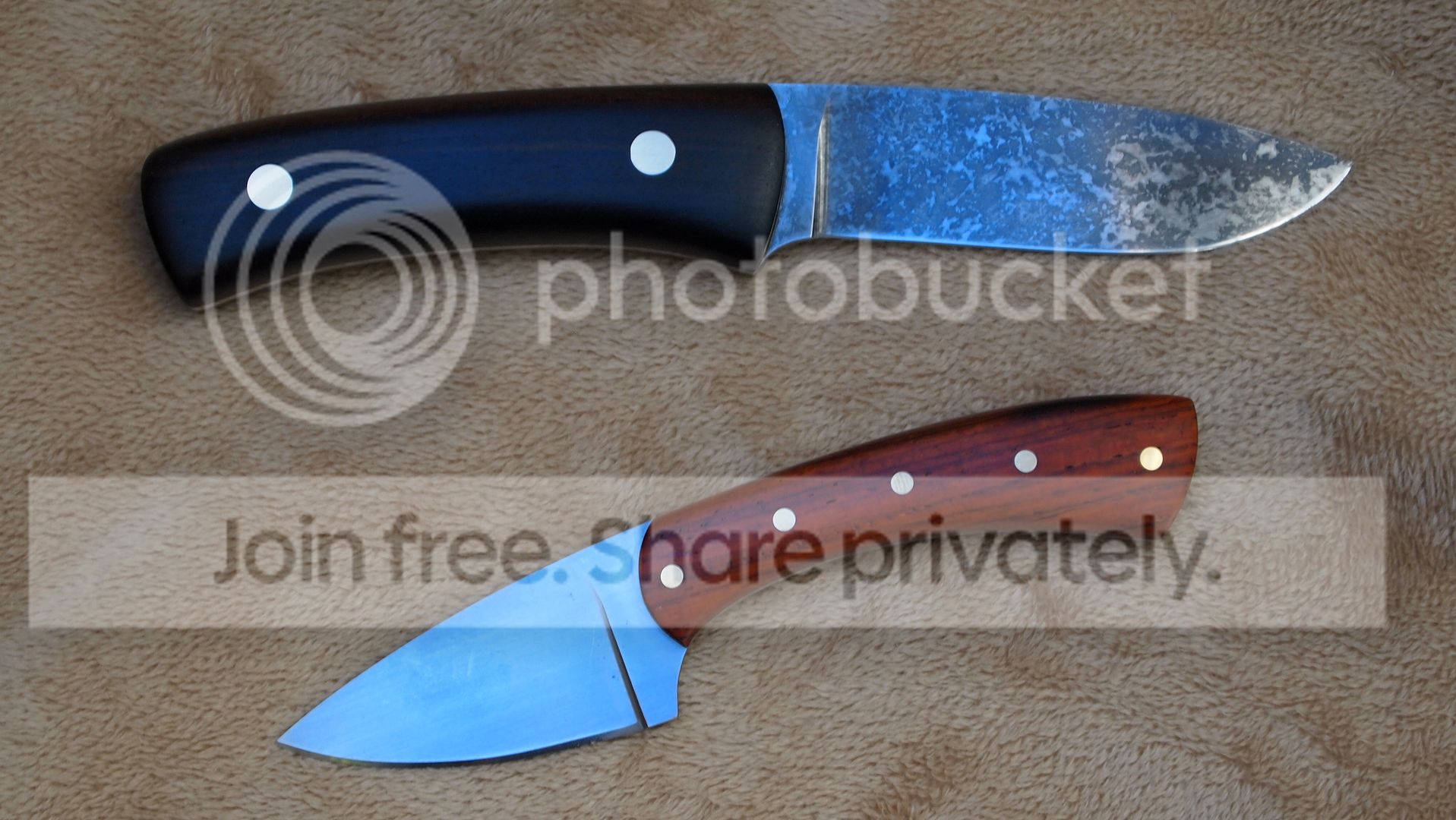

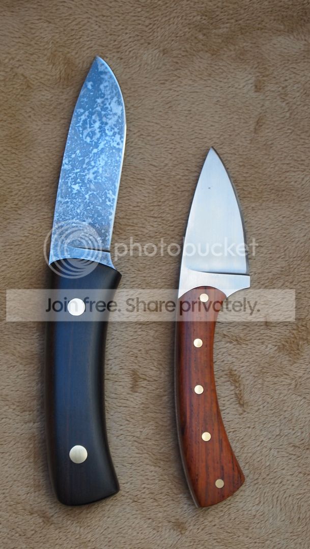

So here are the two knives I have been working on. Been so busy but I'm stoked to finally have had the time to get out and keep learning!
Both are stock removal from Kelly Cupples 1080 1/8" steel.
First is 5 1/2 inches overall w/ 2 inch blade and Mexican Cocobolo scales. Both blade and scales sanded to 600 grit and scales finished w/ two coats of Tru-Oil and then a coat of Carnauba Wax.
Second is 7 1/2 inches overall w/ 3 1/8 inch blade and Macassar Ebony scales. Blade sanded to 600 grit then finished w/ forced patina. Scales sanded to 1500 grit then two coats of Tru-Oil then one coat of Carnauba Wax.

Any comments or criticism welcome!:)
Thanks guys, that means a lot coming from this crowd! :)
Been struggling to get consistent grinds and plunge lines on each side with my HF 1x30 but with a little patience I'm getting a little better at it. Can't wait for a 2x72!
Figured if I'm going to do this like the pro's do that I should start out freehanding the grinds but I think I may try to mock up some jigs in the near future because I'd like to get the plunge line between the ricasso and blade a little more crisp at the top and save some time sanding the bevels.
