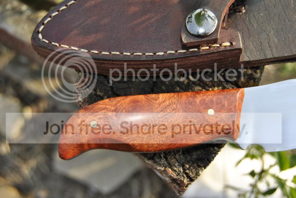

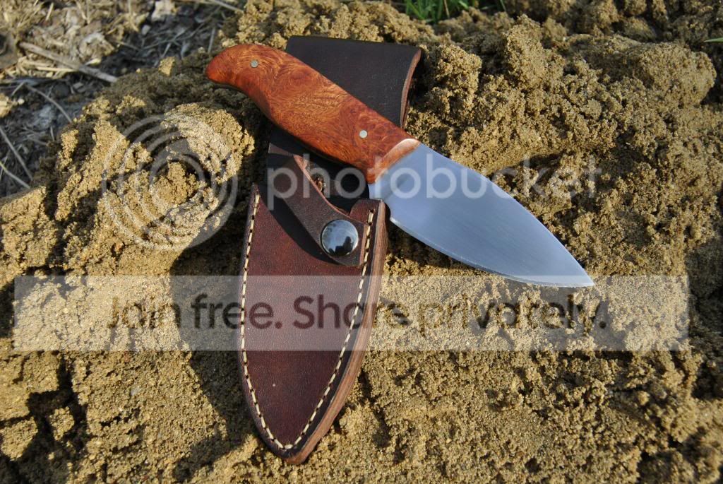

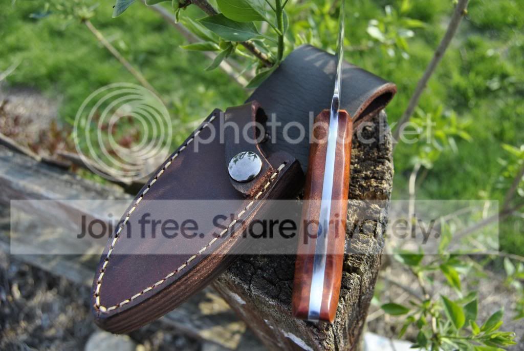

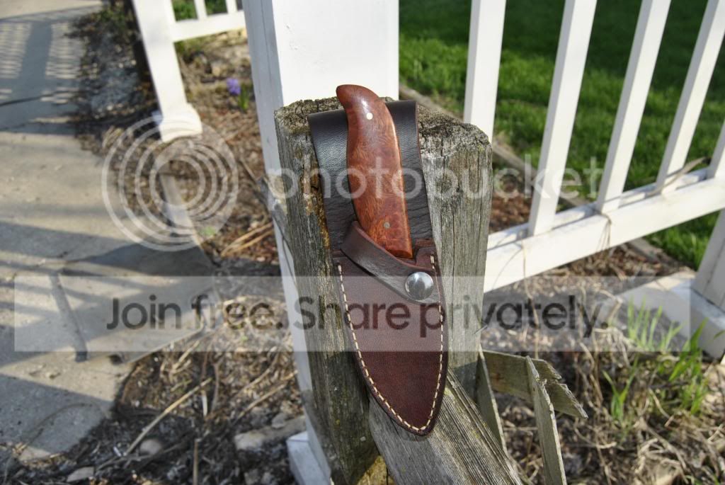

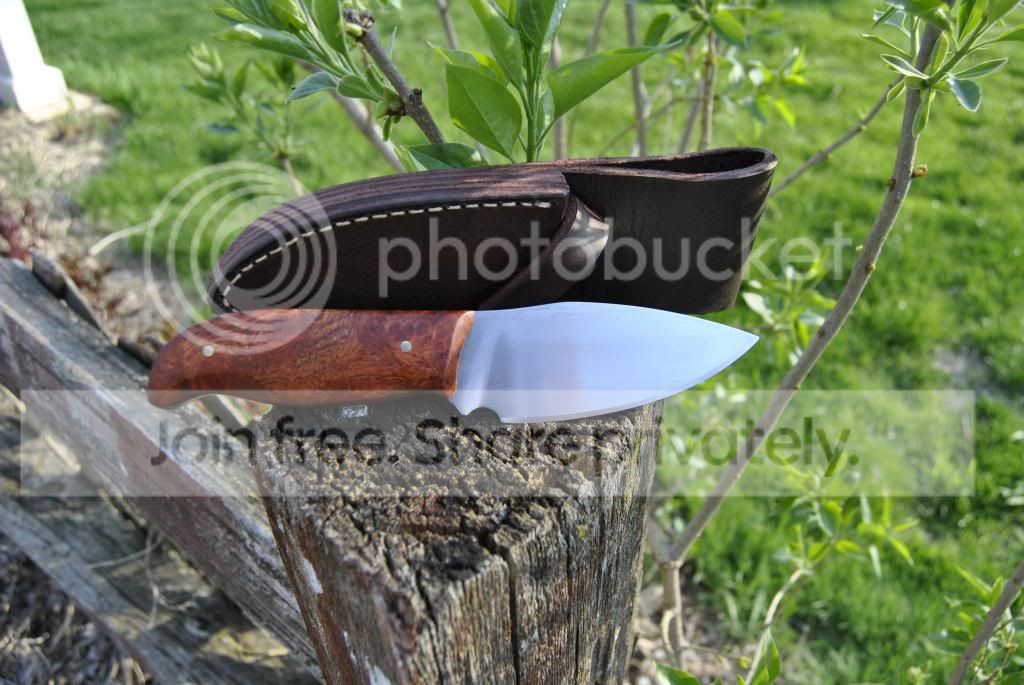

I just finished my 7th knife. I'm not completely happy, as my sheath was supposed to have a double stitch that criss-crossed. I had an issue with the hole placement and had to change it to a single stitch. Other then that, I think it turned out real nice. The blade is forged, 52100. Amboyna burl scales. Blade is 3 1/2" long, knife is just over 7 1/2" overall. I tried doing something a little different, tapering the handle similarly to the blade from back to front. The spine is 1/4" thick at the back of the handle and only 1/8" thick at the front of the handle. It has a distal taper. Let me know what you all think of my design and fit and finish. I think everything came together really well on this one. Thanks!

Sunlight and a real camera are so much better than blurry cell phone pics.

Thanks everyone. 123, I have dyed the edges a good 5 times already, and it just keeps sucking it in and drying a lighter color. I am not sure what edge kote is, but I'll look it up!
So I looked it up. I used Fiebings Mahogany oil dye on the sheath, but I noticed the edge kote doesn't come in that color, only brown or dark brown. Should go with dark brown?

Maybe just use they dye you used so it matches.
Then you can burnish the edge with an antler or plastic stick.
The Sheath forum will have more specific info
Go with brown. Dark brown is almost black. Brown is probably a shade darker than what you used for the sheath (Mahogany.)
I wouldn't use edge coat. Its basically just plastic paint. Your leather work is too nice for that. Just edge it with an edger (probably a #3 or #4) to partially round the edges and then burnish. You can dampen the edges and rub with a stick, canvas or an old piece of denim. Gum tragacanth also works very well for that if ya can find it but beeswax or paraffin works well too. You should be burnishing hard enough you are creating some heat. This is for the edges of the sheath that cover the blade. I'd leave the rest alone on this one but edge them prior to assembly on the next sheath ya make. Also consider creasing all edges that aren't sewn. That will give your work a real step up. Osborne makes good edgers and creasers and they aren't too spendy.

Just burnish the edge of your sheath and leave it. It looks fine.
