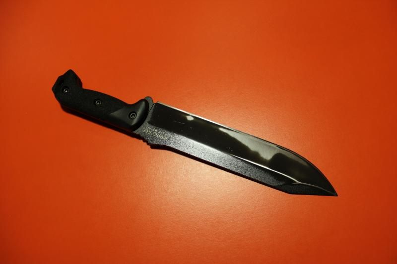

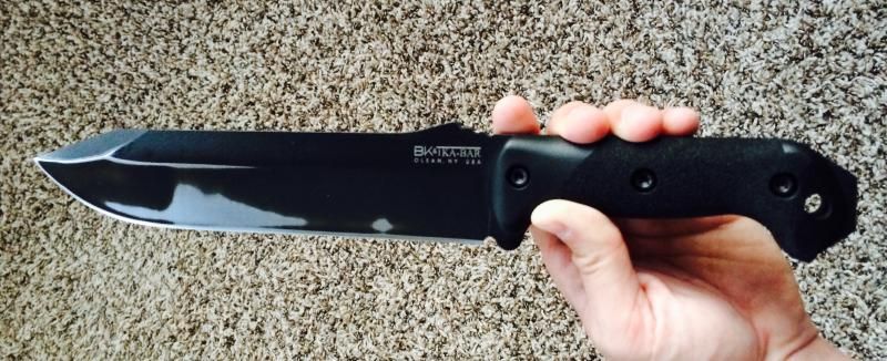

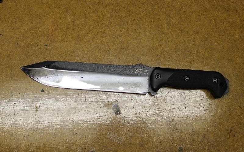

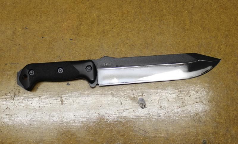

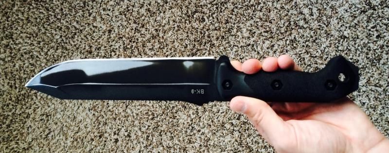

Here's my new BK9. I've only had it for about 2 weeks. I bought a 16 and loved it so much I decided I needed a 9 to compliment it. On my 9 I took sand paper and strops to it to get my grinds even (were very close) and convex the edge. I stippled my scales, per usual, and Loctite the screws. I like the factory sheath for this blade since it seems handy to place on a backpack, etc. Plus I don't find it uncomfortable to wear on my, although that will be rare. Anyway, I've been chopping up firewood with it and even trimmed some long branches on my trees (wife wouldn't take pics of me doing it since it was cold out lol). Anyhow here's some static pics of my wonderful 9!

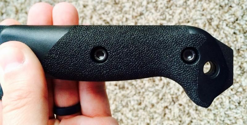

Do you mind posting a guide to your stippling? I have never seen such fine stippling, I usually see larger... divots I guess I would call them. But your fine stippling looks REALLY good.

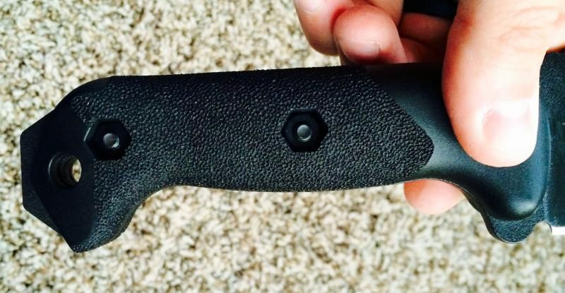

Ok here's my best attempt at explaining exactly how I stipple:
Equipment:
-Fine Tipped Soldering Iron from Wally World (about $10)
-Small block of wood
-Something to drink
Technique:
-Decide on the area you want to stipple based on where you grip and then choose how to make it aesthetically pleasing for yourself.
-Use a marker to mark the outline so it helps guide you (eventually you won't need to do this)
-make sure to press straight up and down into what you are stippling so it gives you even sized/shape dots
-Press lightly and quickly, just until you see a puff of smoke
The job:
-Start by doing the outline areas of what you are stippling. Be careful to not press too deep and to make sure each dot touches another.
-After the outline is done, start at random areas building out your stippling. DO NOT TRY TO DO A PATTERN!!! You want it to be natural looking so don't force it.
-Let the whole stippling meet up as it sees fit, by randomly starting in those various areas and stopping.
-Make sure every single dot is touching another dot, that will give a full completed look.
-When you notice excess plastic, touch your tip into the wood block to burn off excess plastic that has built up.
-After all is stippled, take 800+ grit sandpaper and lightly sand the stippled area to take off loose peaks and pieces.
-Enjoy!

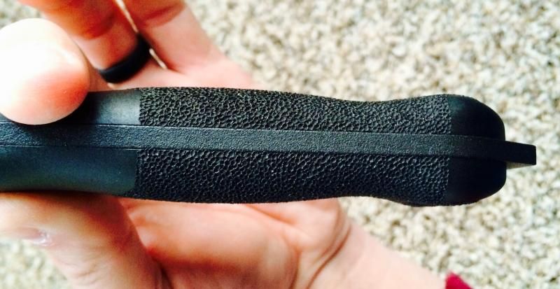

Here's some close ups that show what I am trying to say:
My BK9 I just did:
Should look like velvet when viewed not in macro, but feel like sandpaper:
Other Becker examples of mine:
Hope that helps. Not sure it does hahaha.
