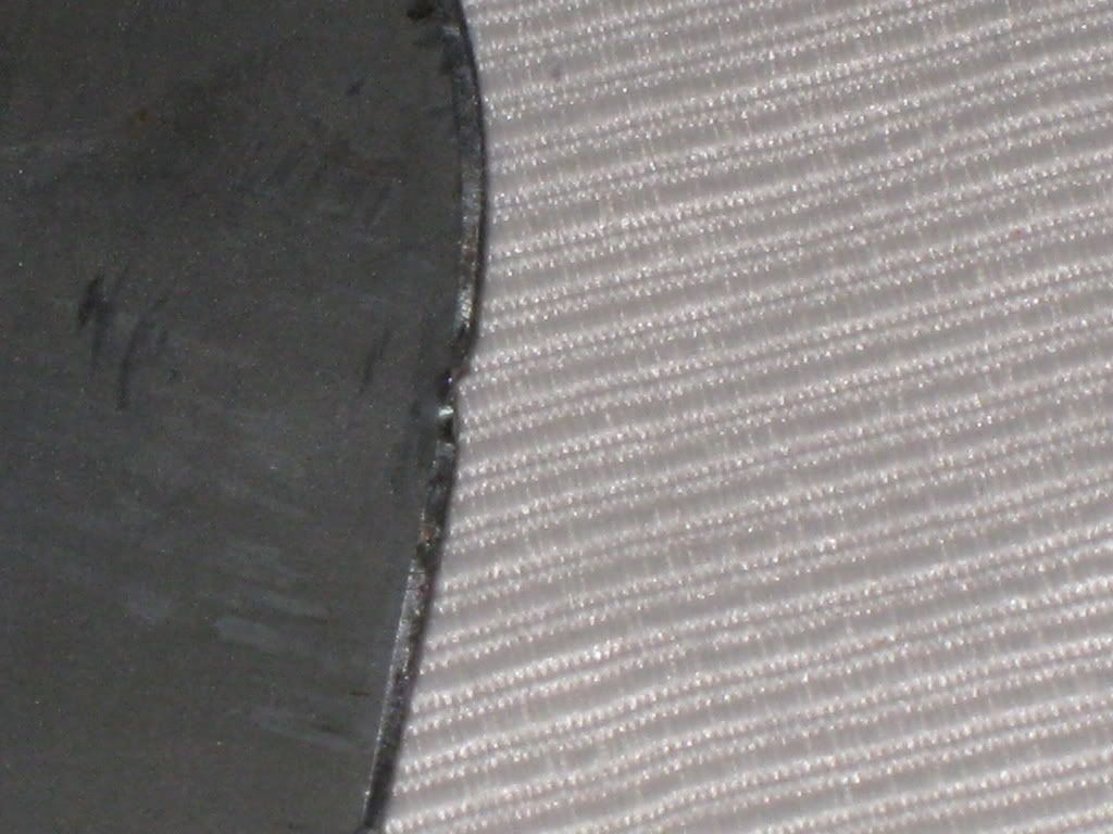

But, with the thinner edge, it seems weaker. My friend played with the blade FFBM for around 10 min chopping things up. Well, it was all wood and small branches. I checked the blade and around 4 little 2mmx1mm nicks have formed in the blade. From what though? I'm not sure, only dead wood was chopped.
Also, I read all of this thread. A lot of talk about "re profiling" the blade, getting "ban" to fix it etc. Well for $400+ I don't think you should have to get a knife re-done. The design should have been finished before it was sold IMO. Overall I'm not impressed with it. A knife needs to be functional (especially from a "combat" company). Being unable to carry it properly really puts a damper on things.
I'm going to the "hoodlum" dirtime event in June. I will bring this FFBM with me. I will use it and if others want, I'll pass the blade around. I'll see if 5 days of field use changes my opinion, or if I just leave it at camp because of the weight.
I have a BM-E. It also is a pain to sharpen and has a horrible edge. I think they improved the edge with the FFBM.
sounds like alot of damage for just chopping wood.....
were they chipped out, or was the edge rolled????
New, I looked for you... The ones near the tip (about 2 inches away) were chipped. They are each 2mmx1mm,
The other 2 (located closer to the choil) are rolled. The first one is bigger then I thought it's 3mm long by 1mm deep and the other is even bigger 4mm long, by 1mm deep
this is very interesting.....i guess it must've been some really hard wood.....i am genuinely surprised that wood would be able to chip out infi.....infi has been used to cut metal and wood should've been no problem for a BM....
live and learn, i guess....thanks a bunch for the field report, it was greatly appreciated......
by the way, any chance that maybe your friend chopped down in to the ground and maybe hit a rock or two????
Whoah...that's totally unexpected. PI, it'd be great if you could get some shots of that damage for us. From all I've read even Busse himself has not been able to chip an edge. A chipped Busse is something almost mythical.

I think it's chipped. I'm getting a new camera, so I'll get some better up close shots. Don't think I can get them with my current one.
As for the chips, I let him "do what he wanted" with it. He came to all the same conclusions I did. I looked at the edge and was very surprised with the small nicks. So I asked him "how did you nick this edge". He knew it was an expensive knife and thought I was going to kill him... Nope, just tell me how you did it....
He said he hit/broke many small dead 3-4" branches, 2x4 etc. I asked about dirt, stone, metal etc. The only think we can think of, was that a dead branch on the ground had dirt on it. So when he hit the branch, he struck small piece of quartz (common in the are and dirt he was chopping).
But, for the rolled metal, I am lost on how he did that...
I would really like to see a photo of that. I've never seen my FFBM chip on anything, and most certainly not on wood, including frozen logs on gravel. I've hit some rock with it "accidentally" (that is to say carelessly since I didn't rightly care if it glanced a rock or no), and no chips.
If your FFBM chipped, then I posit that it was one of two things that caused it - either the blade hit something much harder than wood such as rock or metal, or the heat treatment was off in some way.
Thin is the last word I would use to describe the edge on FFBMs - it's massively thick of edge, and certainly should not chip on wood even if the steel was just good old 1095.
On the topic of edge damage I over thinned my FFBM edge in the pursuit of a stupid sharp blade. Had no problems on any wood I threw at it either battoning, live trees, dead wood or stuff like 2x4"s. I did make the mistake of chopping a beef bone about 35mm in diameter. It was an old favorite of my dog and karma got me for stealing it from him. I chipped about 4mm long by 1mm deep off the FFBM edge. The bone was smashed to hell though so at least I had the satisfaction of that.
Bottom line it was my fault for over thinning the edge so now I have to be a little more careful when using her. No paving slabs, bones or scaffold bars for my mistress i'm afraid.
