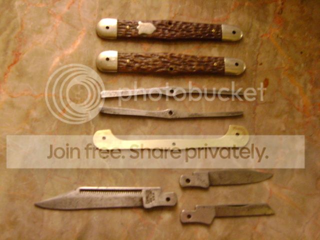

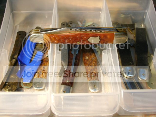

A couple days ago I was digging through my knife collection, which I’m in the process of re-defining for the umpteenth time. In a drawer, in a box, untouched for years, I discovered a cache of Camillus #72 whittlers. Understand that these ubiquitous (made since 1946 continuously I believe) knives are really a stockman configuration that Camillus and the Boy Scouts of America have decided, on their own, to call a whittler. These are dandy knives for whittling with. I always seem buy them when I stumble upon them.
Soooo several of my 72s have broken blades; it’s always one of the small blades, the saber grind main blade looks bullet proof. I dumped the box of them out on my desk and, idly, wondered if one of my junkers could be re-configured into a “true” whittler pattern. So I took a couple, one without any scales (the scales were corroded celluloid/plastic so I pried them off at some point in the past) and another with nice Delrin scales, apart. I cut through the pins with a utility knife and a hammer and the knife fell apart. Piece of cake so far………….. Pretty grimy cake. I’m winging this btw.
Then I took another one apart……………….. 3 down. The pile of parts is growing.

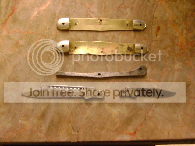

As I sit there, I now have 3 knives in pieces. 7 usable blades, single and double ended springs, a couple of brass center scales, 2 good liners with bolsters attached but no scales and 4 liners with bolsters and Delrin scales. I destroyed all the pins (go figure) but I plan to replace them with 3/32” nickel silver rod anyway.
H’mmmmm. My wife is laughing at me now as I jumble the pieces into various knife configurations, a whittler and swell center, double ended jack. She quietly (that means without rolling her eyes btw) but wisely asks if those blades are still sharp? Good point………………… I dull them with a file.

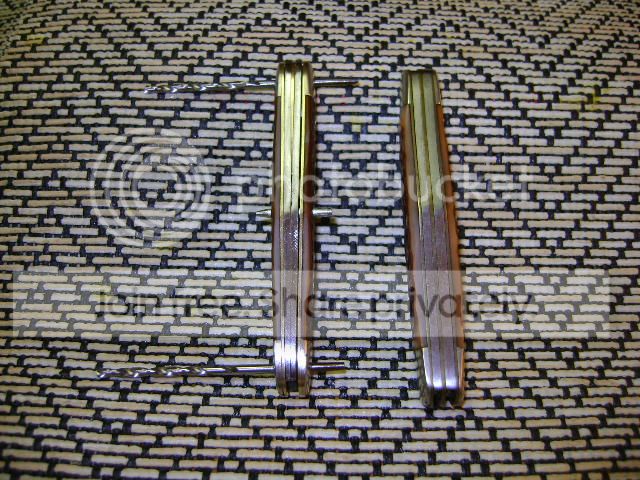

Dug out some .093 drills to use as assembly pins while messing with this thing
Drilled and reamed a set of blades, bolsters, springs, and a brass center scale to 3/32&#8221; (these parts are pretty soft)
Cut the brass center liner into 2 pieces, 1/3 length (1 hole) and 2/3 length (with 2 holes) and filed them so the main blade will fit depending on which I decide to use. I&#8217;m inclined to the long two-hole one but we&#8217;ll see (Ken told me to be really careful of razor sharp center liners which decide to move around in your pocket and slice your leg open). I taper both to about .005 at the front.

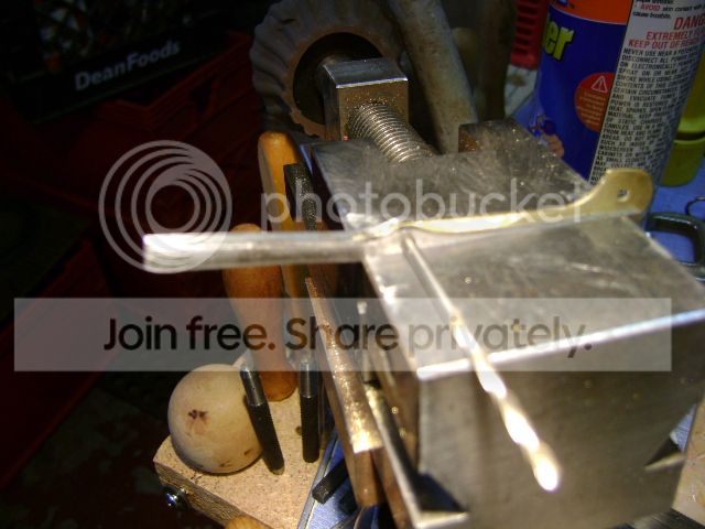

Started tapering 2 double-ended springs forward from the center hole by hand, using a smooth file, which is working like a charm.

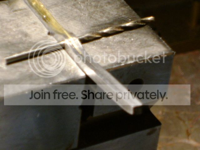

Cut some 3/32&#8221; nickel silver pins and tapered the ends (running against my belt grinder while they&#8217;re in a cordless drill) to make them slide in easy.
Lay out the pieces and put it together as a whittler for the first time. This takes awhile&#8230;&#8230;&#8230;&#8230; it goes together pretty painlessly.

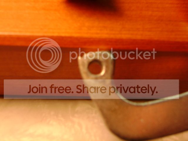

Look it over. Main blade springs need more taper (not sure exactly how to measure the taper) without narrowing the part that contacts the blade itself.

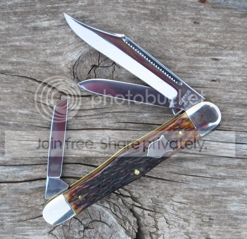

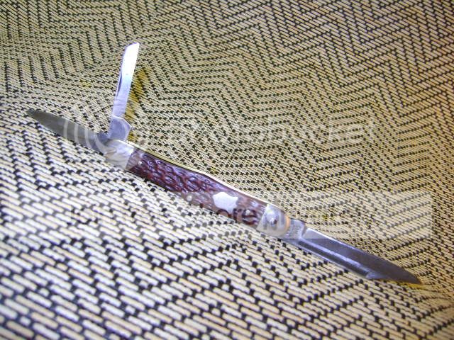

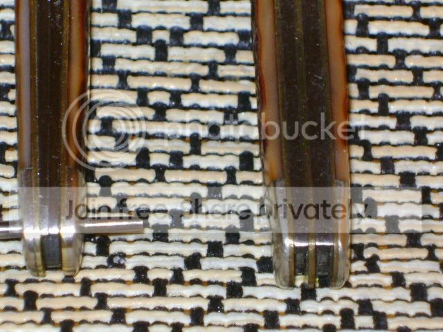

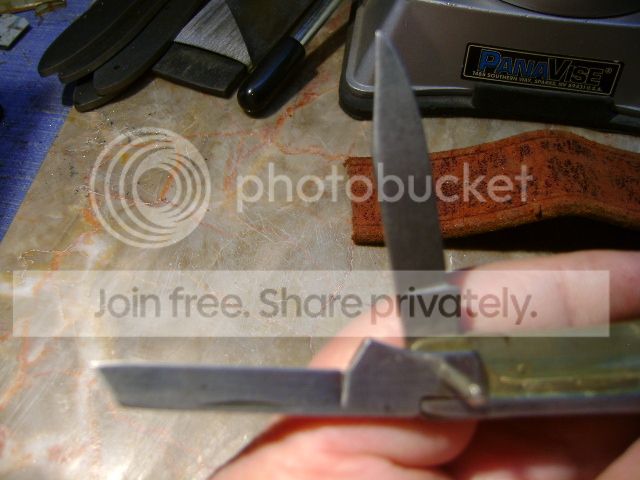

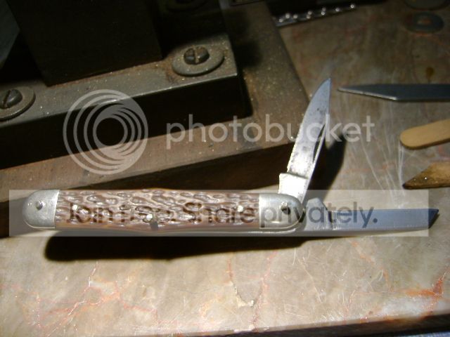

The first "together"pics
Before and after comparison of the modded 72 with a stocker
Now I need to decide how much I'm going to "re-finish" this thing. I enjoy a knife with a well earned patina but this one has had so much done to it already I'm thinking I may as well go all way. I realize that this whole project is creating a "Frankenknife" of a sort but I'm pleased with how it's coming along and what I've learned so far.
My favorite tool used has been a Grobet 6" smooth file. What a joy. The invented spring compressors are a revelation too.

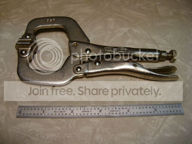

Later I&#8217;ll post some pics of the second one ensconced on an assembly board and a &#8220;new&#8221; spring compressor/depressor I made out of a Vice Grip clamp that&#8217;s a lot faster to use then the others I made.

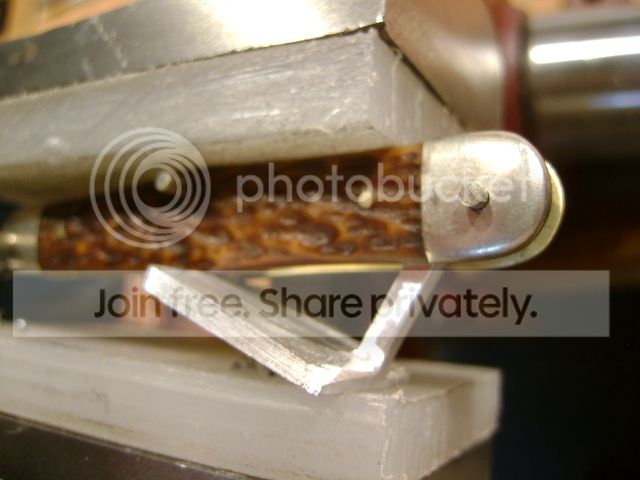

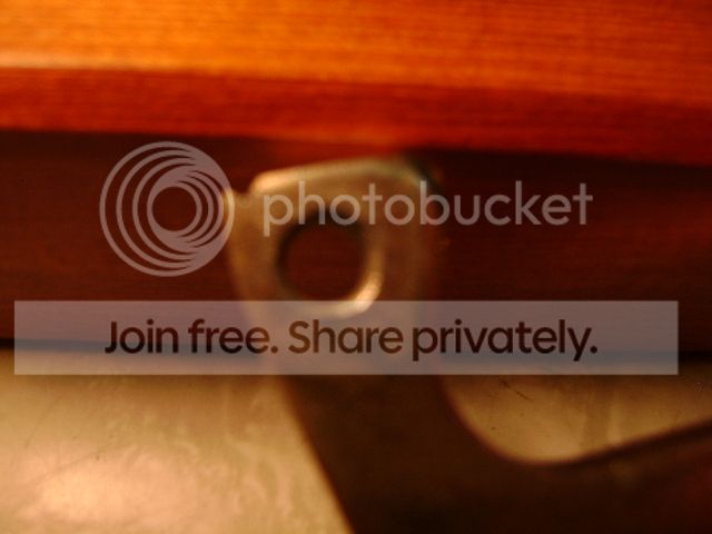

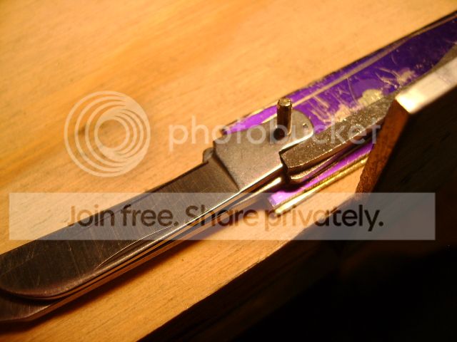

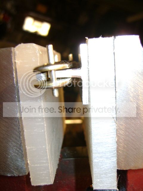

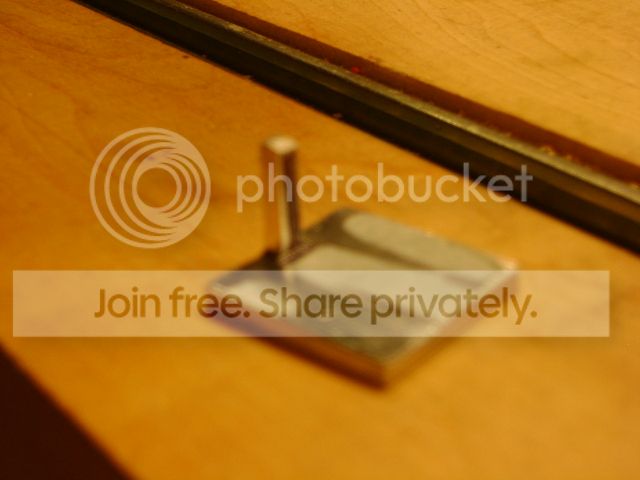

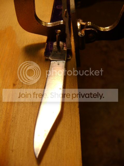

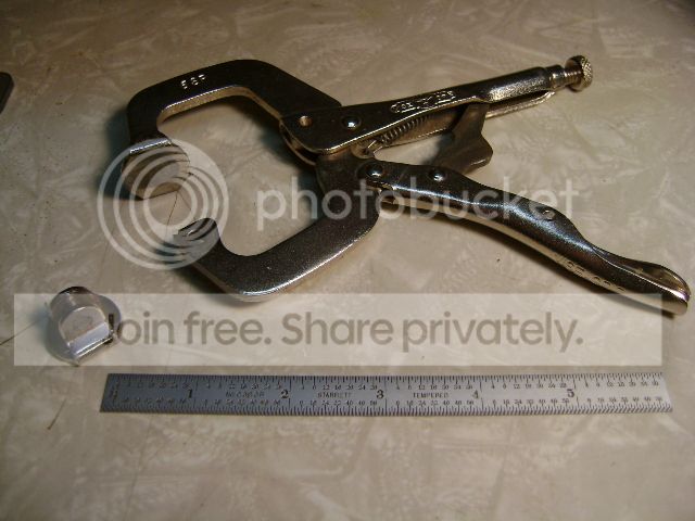

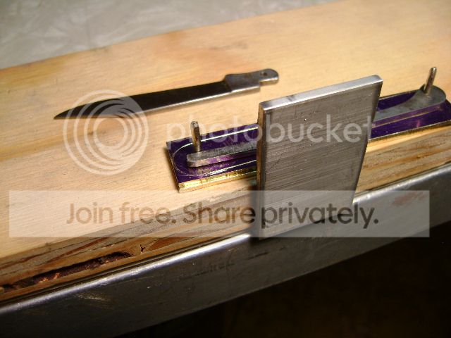

There&#8217;s not much to this spring compressor. I got tired of fighting a strong folder spring while needing 3 hands to pop a blade in place to see how I was doing so I looked for a way to have a strong 3rd hand of my own handy. I thought a vise grip clamp would serve that purpose and it worked like a charm. I&#8217;m sure I saw this somewhere else before so it&#8217;s not an original idea although it may be a different approach. The pics:
The clamp
The pieces of the modified clamp. I ground off the rivet holding it together and beat it apart. I can return that movable endpiece and bolt it on if I need to although I have about a dozen of these clamps in my woodworking stuff (getting left a woodworker's tools in his will helps out here. Thanks Frank)
The clamp end with an angled notch filed in it.

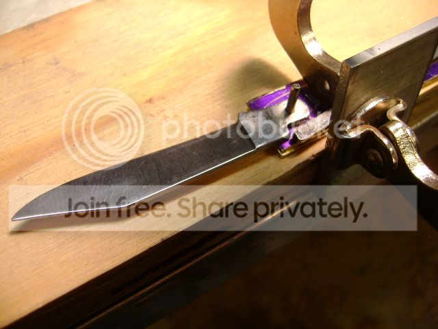

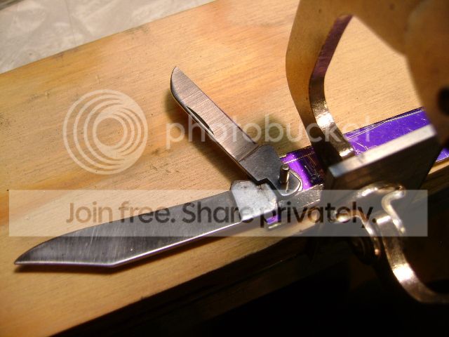

My assembly board clamped to the edge of a table with a piece of aluminum angle butted up against it to clamp to. The plywood isn&#8217;t strong enough to clamp against by itself (ask me how I know this)
The clamp in action

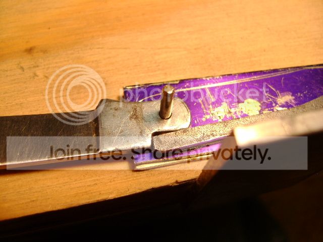

The blade just drops right on the pin

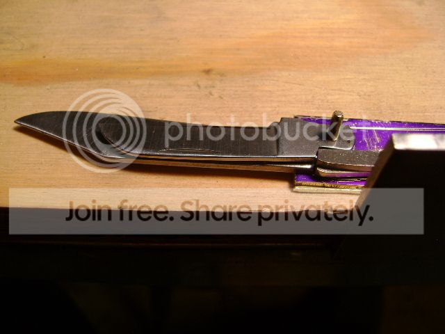

I think I&#8217;ll add a second blade now
There you have it. Note that I haven&#8217;t done ANY fitting of these springs to these 2 blades yet.
