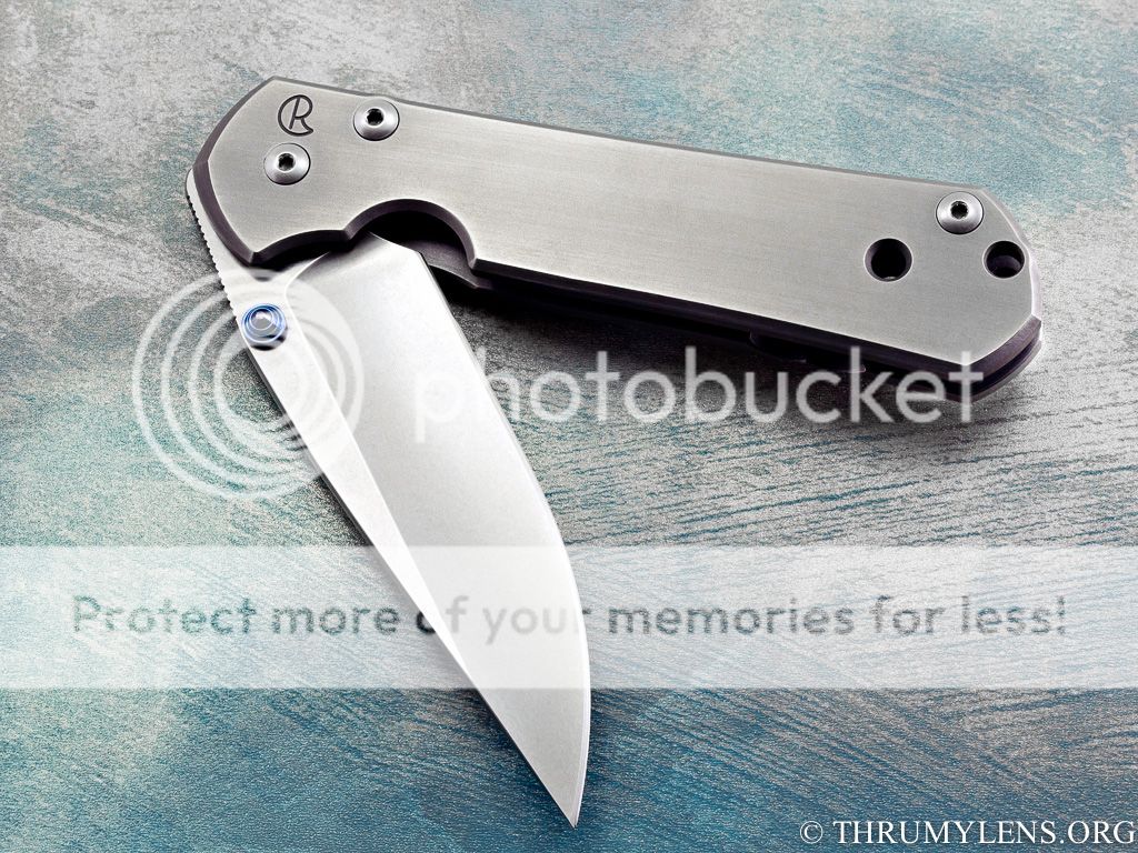

My Chris Reeve Large Sebenza with Brushed Scales (PHOTO)>>>>>>>>>

Simply brush in one direction with a Scotch Brite pad until the desired finish is achieved. :thumbup:
I was just watching videos on YouTube before you posted this. Definitely doing this to mine
I've always wanted to do this mod with a large P sebenza, now that I scored one from Lisa we'll see what it looks like. Thanks Rolex John, love what you did with your Sebenza.
Very nice. I am thinking that required some time and patience.
Not at all. Pretty much just take it apart and start rubbing, only takes a couple minutes.
I put the scotchbrite pad down on a table with something grippy under it, like a piece of that shelf liner stuff.
It's a good idea to keep the blade and washers off to the side, and wash the scales off really well when you're done to get all the grit off.

Thanks for the info. I might have to give it a try.
