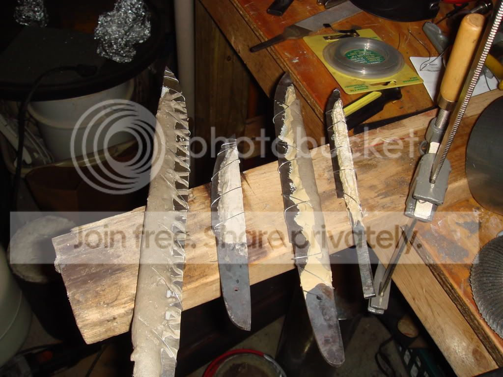

hey everybody....
i have a slight problem.
I used my new muffle forge to HT some blades and they have hard edged (i checked with a file) but the ones with clay on the spine didnt curve like they wer supposed to. now i havent checked yet to see if they even have hamon lines (i spilled all my FC acid)
what could i have done wrong?
is it worht seeing what kinda hamon line? or does the fact that they didnt curve mean they didnt harden right?
i tempered the knives right away so as to not have them stress crack... should i redo them? or should i be content if they have nice lines? the big blade is W2... and i would rather not crack it.
thanks

Hi Chris,
I have never had a blade curve using clay. Not in the direction I wanted,
anyway.
I don't think you are working with enough length to show any appreciable
curve during HT.
Your big blade may not have hardened in the areas where the clay is on the edge. It doesn't take much to interrupt the cooling during the quench.
You will know when you hit it with a file.
Fred
I havent clay quenched any blades for a hammon yet, but I was given some advice which seems to be fitting to pass on for the large blade. I was told to get a good wavy hammon, clay the spine of the blade and then cut UP into the clay away from the edge and take away, and to not bring any clay down to the edge.
What type of steel are they? Were you quenching the whole blade at once as in like an edge quench or point down into a tube? From what i have read the point down into a tube will not curve much at all. But the edge type should curve a little. Down (toward cutting edge) in oil and upward (toward spine) in water.

It takes a fast quench to get a good sori. Water, brine, or fast oil. The blade should go in edge down for three seconds, out for three seconds and back in till cooled off. The blade will curve down at first then up into sori. 1050 will curve dramatically.

How thick is your clay?? If it is too thick it can cause problems. I was unable to get any hamon until I started putting it on about 1/8th inch per side. Also i found that the 11 second McMaster oil should only be heated to around 90F. It loses cooling efficiency over 100f.

The scraping off of the clay on the spine is to control the sori from becoming too severe. It is a trick to prevent breakage on full size katana. It lessens the sori.

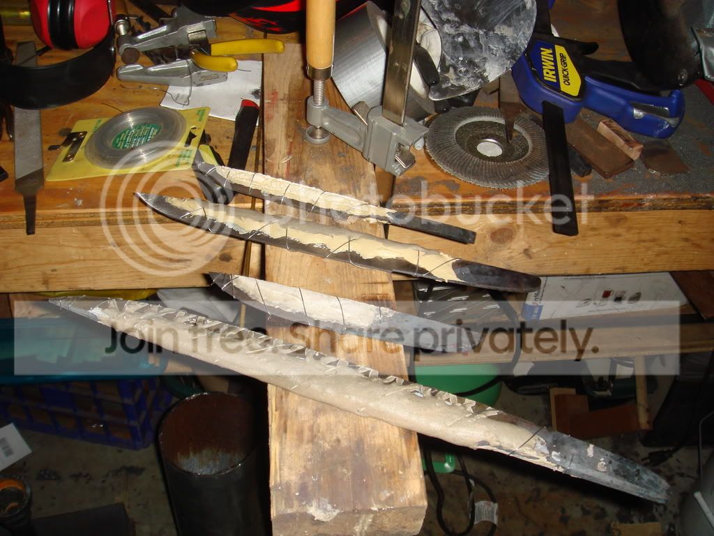

i think it maybe my quenching. i have gotten the negative sori. but on other knives i have gotten a nice curve.
as for the thickness... i got a bueatiful sori on a knife almost identical to the big blade... so i know it is possible... (did i mention i broke the blade?)
i did check the radioshack.. and they do cary it... but they were out... i'll keep trying. i am gonna reHT the knives (except for the ones i didnt want to curve) those i scraped the clay off the back.
i could have put on too much clay... i will lessen the amount. btw... i am using refractory cement with a little iTC 100... it works better than straight refractory and i had a little itc left over. comments?

I have a little experience in differential hardening using clay on simple steels...1095 and 1050. I have quenched a few 5160 blades with clayed backs as well.
In my experience they will all go edge down (reverse curve) or get no curvature at all quenched in oil. 1050 will hardly get hard in oil for me but in every case oil will not develop positive curvature for me.
Water is the way to go if you want to develop curvature in the quench.
