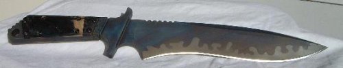

Here are a few photos of my contest knife.
Maybe I can get some of my pals to hook me up with some good photos soon. It's kind of hard to see the color in these.

Holly Crap!!! Nothing lame about that!:eek: :eek: :eek: That is a Dream knife. Just because I like to torture myself, could you give the specifics on that work of art. Materials, size, insperation, whatever comes to mind? Thanks, Reagan

Mick, is the knife blue due to heat the treatment. I was just re-looking at one of your heat treatment/tiger stripe explantions, and you said that S30V turns blueish. I was just wondering how you got it blue, and to say again, its an amazing knife. Thanks, Reagan
Actually, from what I understand, the blade is Titanium, with a Stellite edge incorporated (that wavy "hamon" is actually the line of demarcation between the ti and stellite).

Okay really quick,
The knife started as a ½ inch thick piece of 6AL4V Titanium.
All guards are integral.
The cutting edge is Stellite, which has been press fit, kind of like a jig-saw puzzle.
Handle is Mastodon ivory, which sits inside an integral carbon fiber pocket.
Blade length is 10 inches.
