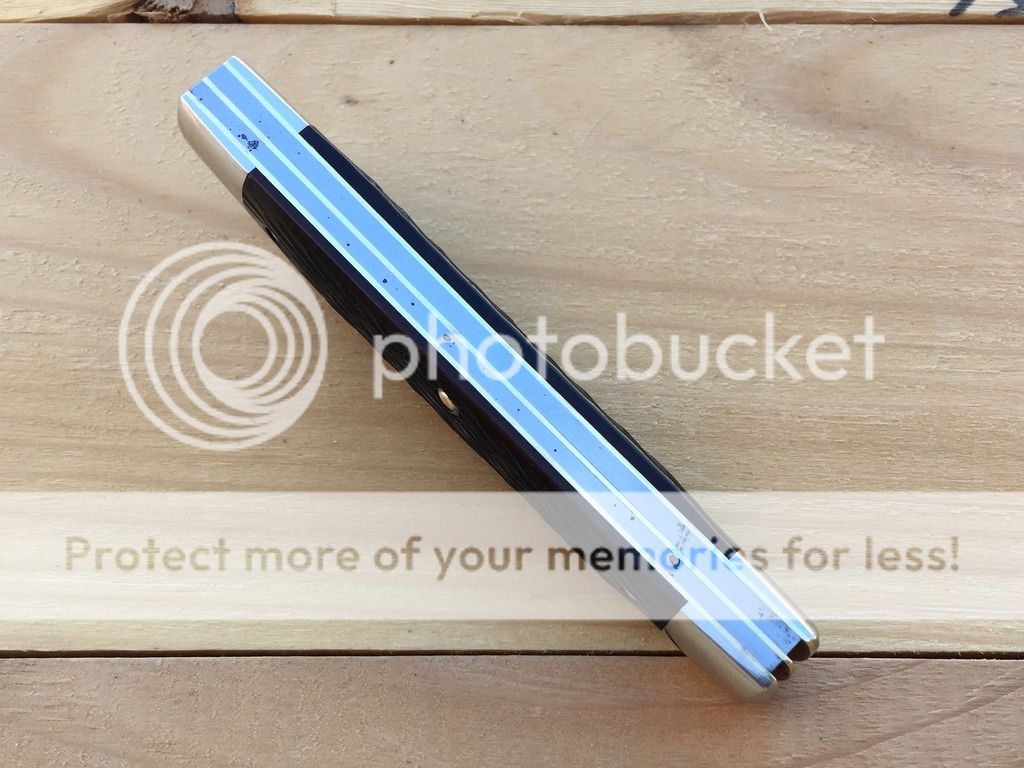

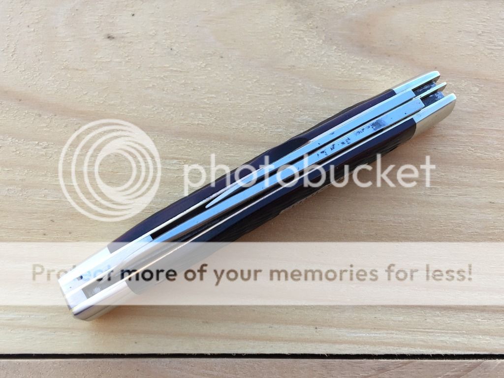

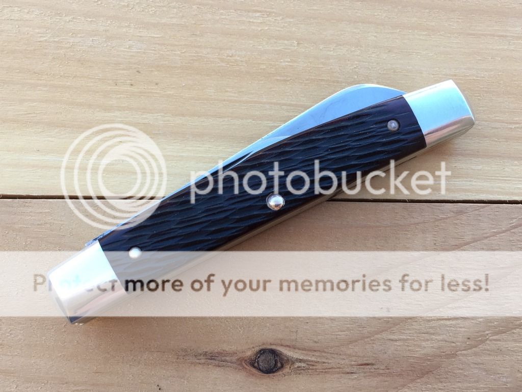

Before:
After:
As you can see, it turned out pretty dark. I sort of expected that to be the case. I went back and forth between the Dark Brown dye and the Chocolate Brown, but because the red was already pretty dark to begin with, I don't think it would've made much of a difference. In person, along the edges and towards the bolsters, it is a rich, dark brown (looks quite nice, really), but that just doesn't show up very well in the photos.
The dye job does do a bit of a number on the bolsters, springs and blades. When I took the knife out of the dye, most of the metal that had been submerged had taken on a splotchy, bronze-ish tint, and there were dark spots on the springs and parts of the blades. (Thankfully, I did not submerge the blades with the knife, but left them half open and sticking out of the dye/water. This didn't keep them from getting some spots, but I think it would've been worse had I submerged the whole knife closed.)
The bronze tint on the bolsters, shield, backsprings and tangs took some polishing to get rid of (I just used a rag with some green compound on it), but having done that, they look just as good as new. The darker spots on the springs and blades didn't come off, but hey, it's just gives the knife more character. :rolleyes:
It would have been great if GEC had offered the Speaker Jack in the same deep chestnut color they used for the American Whittler SFO, but I think this is the next best thing. :D

The spots on the blades and springs should work out with some elbow grease and if needed, some emery cloth or scotchbrite pad work. Either that or let the patina continue and watch it evolve...I love a nice patina. The dye job came out great tho!
Matt
Matt
Thanks, Matt. I'll probably just leave the spots and let it patina more. I gave 'em a pretty good go already (had to in order to get the discoloration off the bolsters). I'm sure there's something more effective than green compound on a cloth, but it was all I had handy. :rolleyes:
I should've taken an after-dyeing-before-polishing photo. It looked pretty scary when it first came out of the pot. :eek:

If you look up my threads on RIT dyeing, you'll see I have had a similar issue with one knife, which I put down to the dye not fully dissolving in the water before the knife was added. I've been more careful to boil and stir since then, and haven't had the issue return.
these spots are small craters and won't come off with metal polish
I hear ya! I dyed my recently purchased Case Trapper...a couple times actually and the bolsters came out yellow each time. Some 1200 grit, polishing compound and some steel wool and they look better than when I got it. Did the same to the back springs and then used steel wool and a green scotchbrite pad on the blades. These are stainless tho, if it were one of my carbon blades it would have a patina from use anyways so Ide likely just get the darker splotching down a bit and then let it even out over time!
Matt
RIT dye stovetop method causes pitting in carbon steel. I have had no problems from it with Case stainless steel knives, but I won't do it (again) with carbon steel.
Anything discolored by the dye process (bolsters, liners, stainless blades and backsprings) can be buffed back to normal color and shine with some metal polish, but the pits are there to stay.
