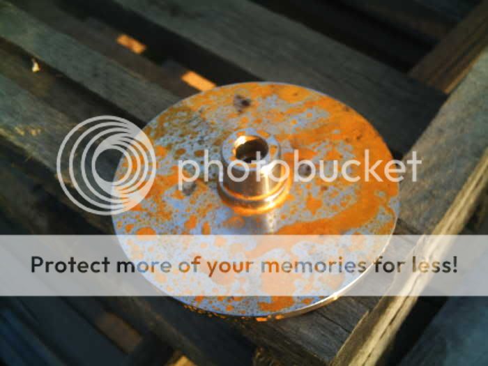

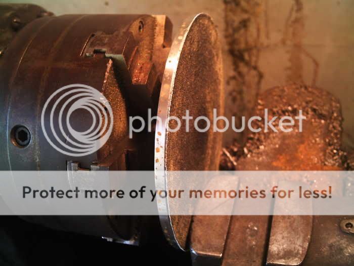

I'm really tired of trying to make things flat with my belt grinder, especially the end of the handle material that butts up against the guard. I don't have the money right now to buy a real disc sander, so here's what I'm doing.
I got the disc at my local scrap yard. I'm not sure what it was originally made for, but it works great for this. They had a bunch more.
Anyway, it works great. It would be nice if it spun faster, but I can live with it. It gets things flat.
I made an aluminum platen for my lathe also and it works great. Multiple speeds and reversible. Better yet when I am done I put the platen up on the pegboard out of the way. I have also seen people do that on wood lathes. I refere to my lathe as my giant dremel tool considering all the cool stuff you can chuck up and use. I have a huge collection of die grinding stones that let me do all sorts of detailed grinding.

rashid11 said:
I'd keep that grit away from me lathe's bedway :)
Get HF's 4x36
I guess that could be a problem. I'll be sure to wipe it down each time. :)
if I buy a disc sander, I'd probably get a disc from Beaumont's.
I got some 3M spray adhesive from Ace hardware. Haven't tried peeling the paper off yet, but I think it'll work ok.

if I could ask :confused:
what is the OD of that
and the ID of the shaft bore?
and price?
it looks only about 6" I'm hoping more.
I maybe able to use a couple three of them..:)
Mine is 9" so I can use regular sheets from the hardware store. I have a 6" that has a hook and loop pad that I use for the cermic/zirconia pads. With a lathe you make as many as you want as long as you don't exceed the diameter of your lathes cutting ability.
Rashid11, I put panyhose over the air intake of the lathe and belt grinder motors. Anything that gets past them is going to blow on through and not cause a problem, and hasn't yet.
and price?
It is indeed 6". :D Big enough for me, but bigger would be nice.
The shaft bore is .59" Odd size, but these things are pretty soft, so you could easily drill it out to 5/8" or bigger. Also, there's no set screw, so you'd have to drill and tap for one, if you're planning on using these on a shaft.
As for price, I paid $.25 per pound. :D I don't know what would be fair to charge you, but I'd be happy to send you (and anyone else) some. If there's any left. Stuff moves fast at this scrap yard.

I can just barely get two discs off one sheet. There's a few places where it doesn't go all the way to the edge, but that's ok with me.
