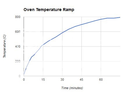

Minor update. I collected temperature data on my 2nd hardening run. It takes about 70 minutes to get up to 800 C and about as long to cool down to tempering temperature. The outside doesn't get all that warm. The controversial heat shrink tubing in the wiring box hasn't shrunk (yet).
Here's my temperature chart:
