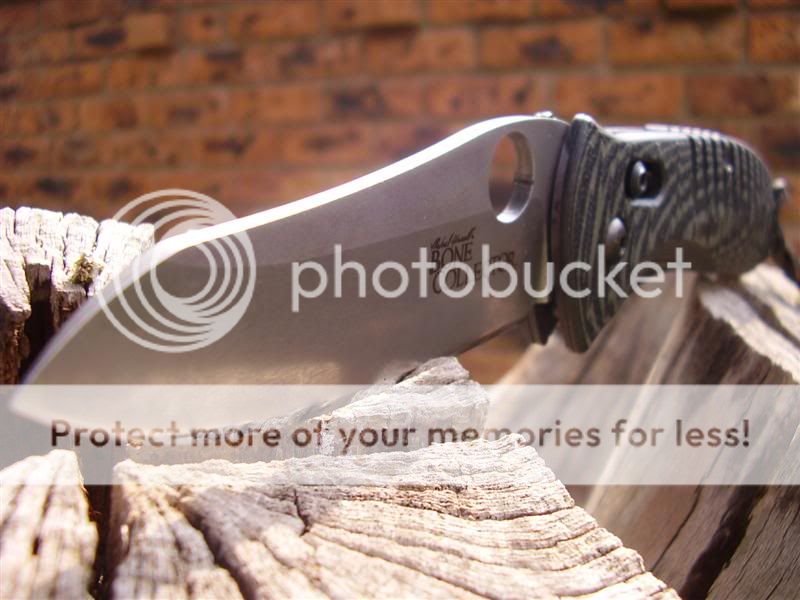

So...here is my process.
1. Put the silicone stone, of my father, in a bench vise at 10-15 degrees (measured as good as I can)
2. Reprofile with a old silicone stone holding the knife horisontal.
3. Dont stop until burr forms
4. Continue process on of 2 and 3 on stones I have with lansky kit from 220 grit up to 1000 grit.
5. Use buffing wheels with green compound
6. Light leather strop with green compound.

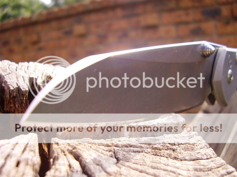

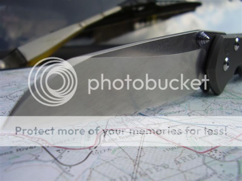

Results:
154CM
S30V
D2.
To maintain if edge is damaged.
1. Use lansky turn box kit (or sharpmaker) at 20 degree angle to create a micro bevel
2. buff
3. leather strop.
In the field:
1. 600 Grit diamond paddle
2. Strop on 1200 grit sandpaper
3. Leather strop.
So far this has worked great for me. Your thoughts and comments on my method or improvement strategies are welcome.
Seems like your method turns out brilliant results, I like the different steel comparison, very cool.
I think many of us have preferred methods, but it is highly disputable regarding superiority of one method over another...and in my opinion it generally comes down to personal preferences.
Your methods seem to produce nice looking results, the performance is harder to assess from photos, but I presume that they perform well for you also.
It would be pretty hard to recommend any methods or improvement strategies without knowing where the edges are lacking. Is there anything you would like your edges to do better?
