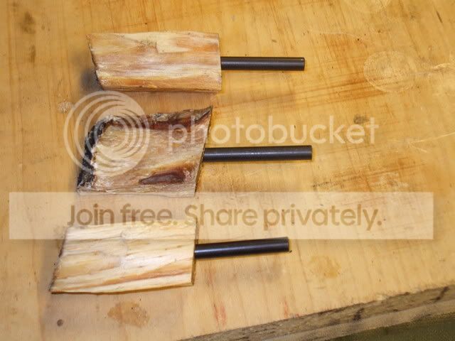

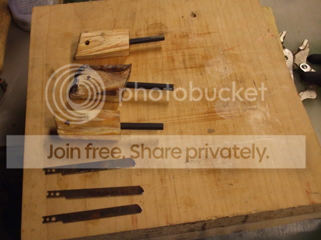

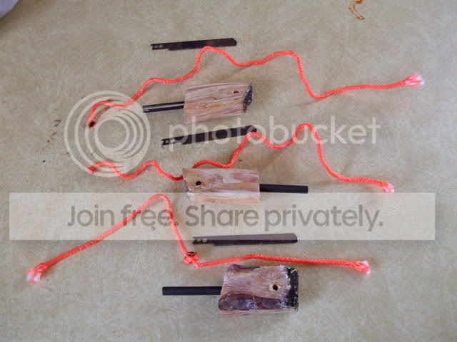

This is my entry for American Bushman's Fire Steel Contest. My thinking on this project was to have ways to aid bad weather fire starting, attached to the fire steel (fatwood and jute), so you wouldn't have to worry about leaving them at home or searching you bag. It is a piece of fatwood with a 1/4" Going Gear fire steel. Marshall also sent me a piece of hack saw blade for this project.:thumbup: The fire steel is friction fit (very tight) into the fatwood, so you can replace the fatwood in the future without having to worry about the epoxy. The hack saw blade is attached to the fatwood with 2 1/2" feet of jute tied into a lanyard and than a small loop for the blade.

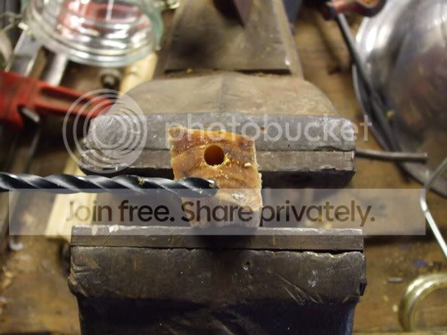

The fire steel blanks from Going Gear are great. I was throw sparks to the ground while standing. I figured in wet conditions, you just untie the jute (enough for few fires) and shave some fatwood. Fatwood does gum up your drill bits and saw blades though. Fun project.

Just mailed it out today. I went camping this weekend, and I wanted to try it out before sending it to you. I brought 2' of jute and an extra piece of fatwood, so I could test it without destroying it. It worked great. I folded over the jute a few times and cut it into 1-2" pieces. I then frayed the jute to create a giant fuzz ball. I made 30-40 fatwood shavings and put them on top of the ball, and then put the remaining fatwood pice on top of that. Worked like a charm.

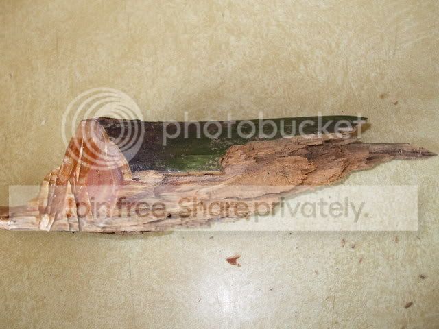

Can I suggest making a "blade cover" for the fire steel instead of a handle of fatwood. this would give you more material to start fired with and could be replaced as it wore away without having to make a new handle.
Just a thought
Just a thought
Ssshhh, that is going to be my other entry into the contest.:thumbup::D I just received some 3/16" fire steels that I'm dropping into a 1/4" hole. I'm going to wrap the fatwood with jute, and secure the steel with a mini carabiner.
