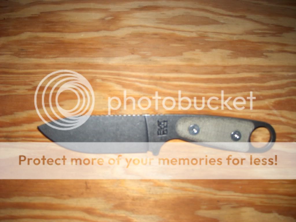

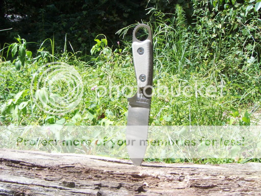

Hi everyone. I just wanted to show what I have done to my Eskabar.

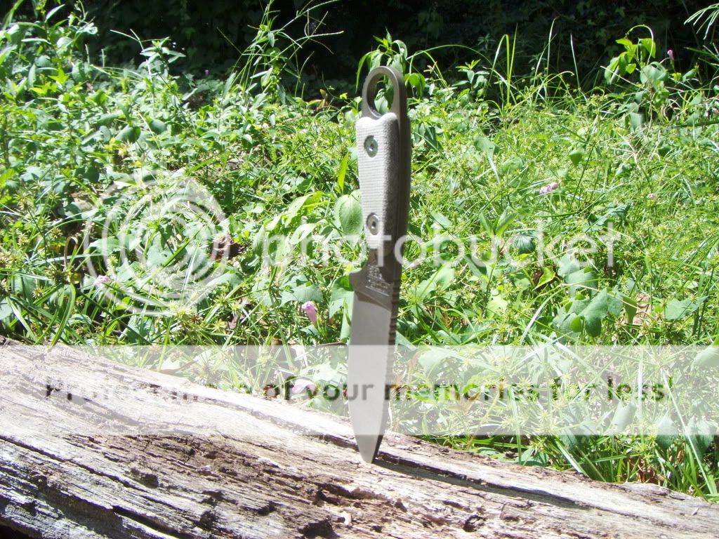

Here it is at work yesterday. I added the jimping along the spine a few weeks ago.

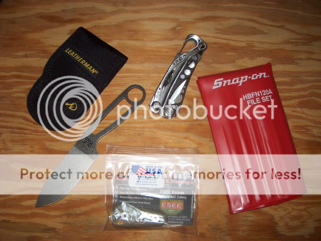

Next, I took it to the media blaster.
My Izula scales arrived the same day. With a little filing, they fit snug with a snap.

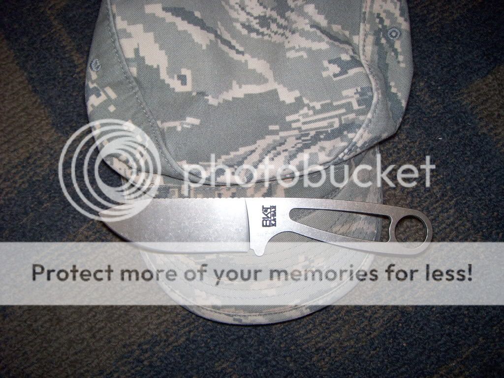

Test fit.

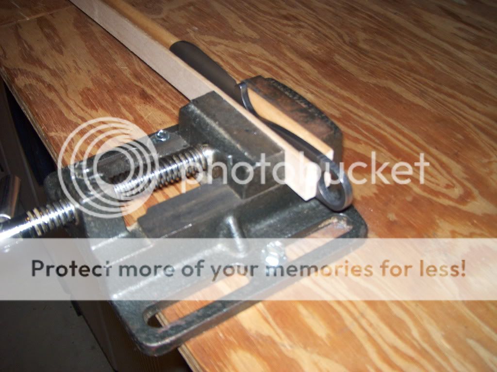

I added some jimping to the underside of the ring.

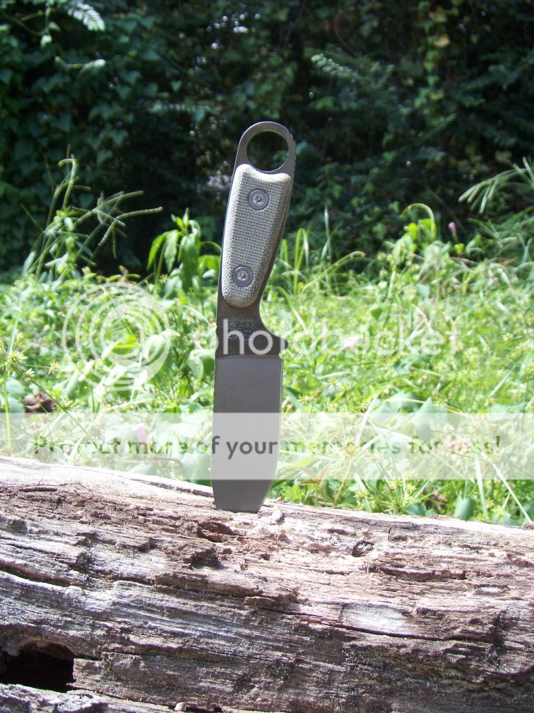

I forced a patina on the handle and spine with apple cider vinegar. I plan to let the blade patina naturally.
And here is the finished product. I tried to show the ring jimping as best I could

That jimping looks real nice and pretty even. Details?
I just measured out the distance (1/16" to 1/8") with a 6" scale and marked it with a sharpie. I cut in about 1/16" with a half-round file, then finished them all off with a very small rat-tail file.

getting those grooves spaced evenly is a real headache, ain't it? :D
