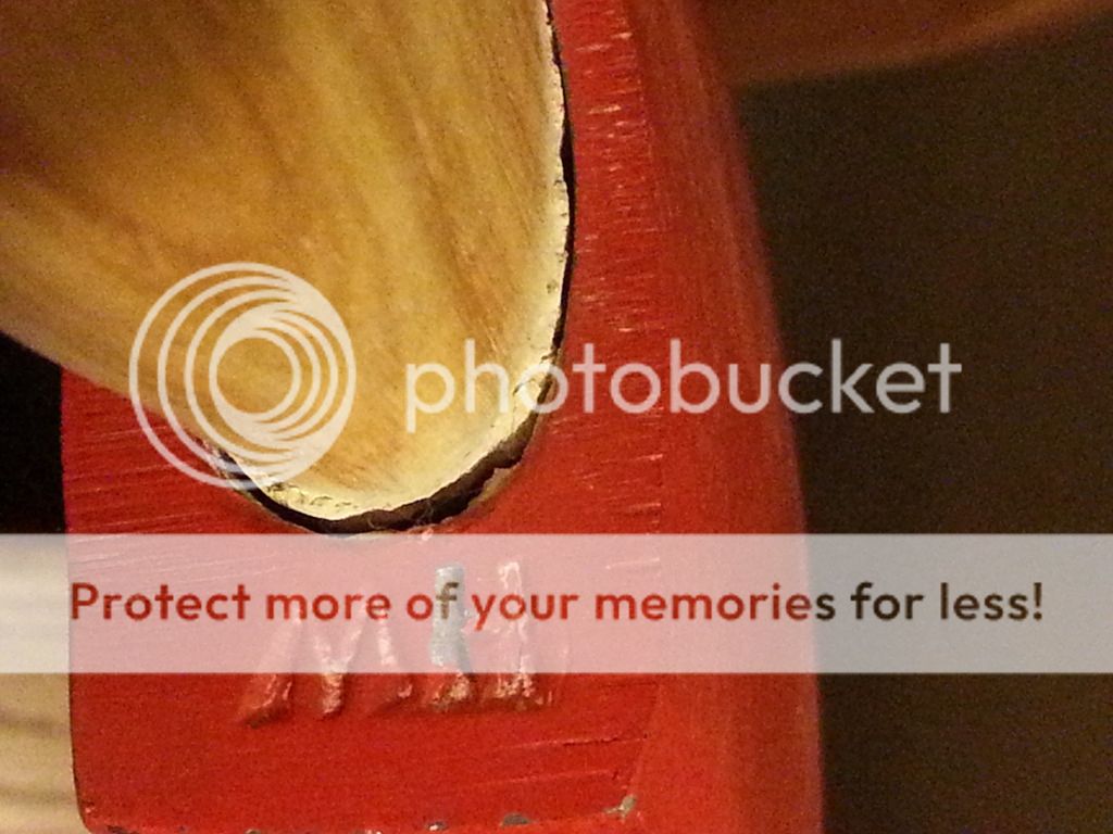

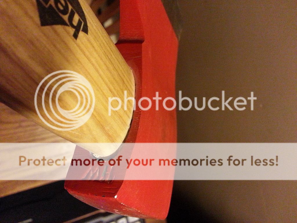

So back in the early Spring I was looking on Helko's site and saw that they had a special deal on their European hatchets and I bought one for $22.00 plus shipping. After ordering, I was advised that there was only one left and that it had a handle that was slightly hung crooked. Cosmetic only and I was given the choice to cancel the order or accept a free leather sheath. I accepted, as I could use it and may choose to fix it down the road if I ever wanted to. Again, it was framed as a cosmetic issue only. I still had every expectation of a regular warranty that would cover normal defects/flaws product failures that was a result of such things.
After one use of the hatchet, it was very apparent that filler had been used around the head to hide a god awful hanging and that there were large gaps on 3 out of 4 sides at the shoulder. I contacted Helko regarding this, and the series of e-mails are what follows.

-Here you are, please let me know if you need anything else.
-Hello Justin,
Thank you for taking the time to send me those pictures.
I cannot say for certain how this particular axe was hung, although from the photo it does look as if some type of material is inside the eye. This is not a standard practice used for Helko axes. However, I would like to point out that this particular hatchet you ordered is our German Standard European series. The European series is our most economical product series we offer. These particular axes should not be held to the same standard as our premium line axes. The cost of the product clearly separate and distinguish them. This axe was priced at $22, which is an exceptional price for a German forged axe head with German steel. The handle is not the same type that is used on our other axes. For the European series, we use lower cost handles from an assortment of hardwoods. Our premium lines of axes are made with superior handles made in Switzerland from sustainably sourced and FSC certified American Hickory. These handles alone cost around $30 to $45 on our website, as they are some of the finest handles available, and are an important part to an axe's overall quality and integrity. In fact, we no longer sell this product line series of axes.
It is my opinion that the handle does not necessarily need to be replaced. Unless the head is loose, as long as there is a secure fit the tool will still function. If the head did come slightly loose, a common fix to it is providing more security in the eye. If you drive in an additional straight wedge, the handle will expand at the eye, thus forcing a more secure fit from the handle to the head. I have done this myself with tools over the years, and the technique works very well.
Unfortunately, these types of hand tools are not indestructible, and may occasionally need tending to. If you would like, I can offer you a 25% discount on one of our handles, should you decide to replace the handle entirely.

There WAS filler used. It is obvious in the picture. Also, I had no complaint when I received the axe as I did not find fault until using it.
