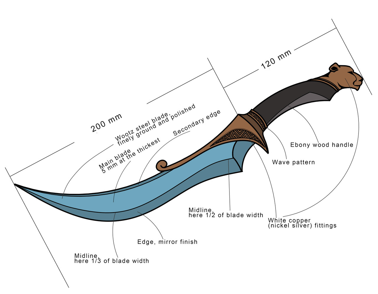

Design 1: Curved hunt knife with Cheetah headed pommel
The design drawing:
My idea: I want something both exotic and elegant. The curve reminds me something like Indian or Arabic style. The cheetah is my favorite animal which is both wild and elegant. The wootz steel has beautiful texture paired with the wave patterns on the guard. Ebony's black color makes adds some mythical and stability.

What can be drawn in a design program can't always work in reality. Your other "bowie" design is a good example.
While this is a pretty fantasy knife, it would be extremely complicated to make and very expensive. I suspect you are just drawing them for fun, and not intending of having them made in steel.
BTW, what you labeled as "wootz" is better termed "damascus" (unless you are taking the fantasy part even further).

Thanks and you are right. I did not expect any of my designs to be easy to implement, and given I'm not a bladesmith, I even have little idea on how difficult they are. My intension is to learn the reality while sharing my creativity. If however my works can give some hints to the blade makers I would be more than happy to contribute more.

I say this works and it is pretty cool, totally doable but very high skill. It would likely be a collab knife where someone else did the carving, engraving.
Wootz too, yep. If you really wanted to make this I'd look for someone in eastern Europe that already has this style.
Cable Damascus might look right too.

"Curved hunt knife"
Why call it a hunt knife when it is very obviously entirely impractical for any aspect of a hunt? The last rendition, behind the woman's back, is the least impractical, but still it is clearly a ceremonial dagger, and not any sort of hunting or fighting knife, by design.
The extreme needle like up-swept tip is a problem for using. Not good for stabbing, not good for gutting, too far from line of handle for control, has to be thick to avoid being weak, so no good for fine work...basically, don't do it. The extended guard along the spine limits cutting depth, which is usually not desirable. The lump on the spine/guard will make sheathing difficult and really impedes cut depth.
Using AI to render a fantasy blade might be a fun, harmless pastime. If you want to actually design a usable knife, the next step might be to cut the shape out of cardboard. I can tell just by looking at it that you could never fit that knife into that sheath.
Research Middle Eastern / Near Eastern dagger designs to see what has stood the test of time. But, if you want a fantasy wall hanger, carry on as you are.

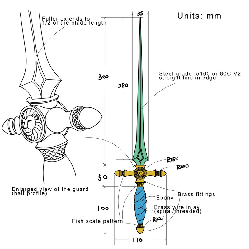

Now it comes my 2nd design - A stiletto.
This time it's more a renaissance style - of course not so serious. Still add some of my personal flavors.
Design graph first:
Now the rendered effect (with sheath as well)
Note the render by AI is not so accurate this time. The edges should be straight lines instead of curved. I tried hard but could not get AI generating the accurate version.
And with story telling pictures:
This time would it be a bit more practical? :p
