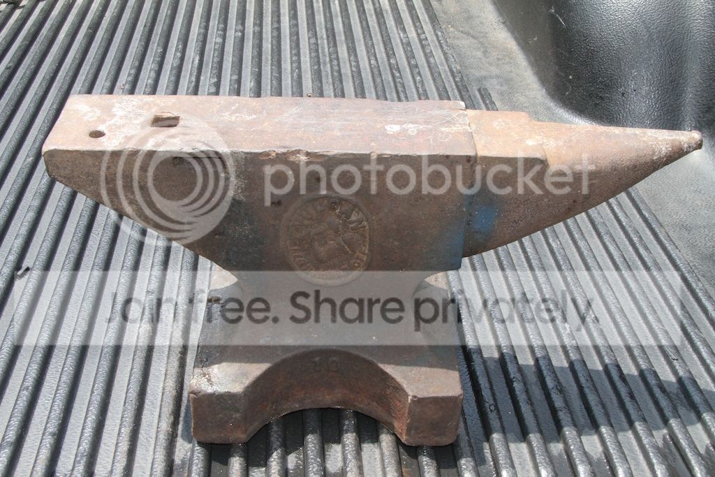

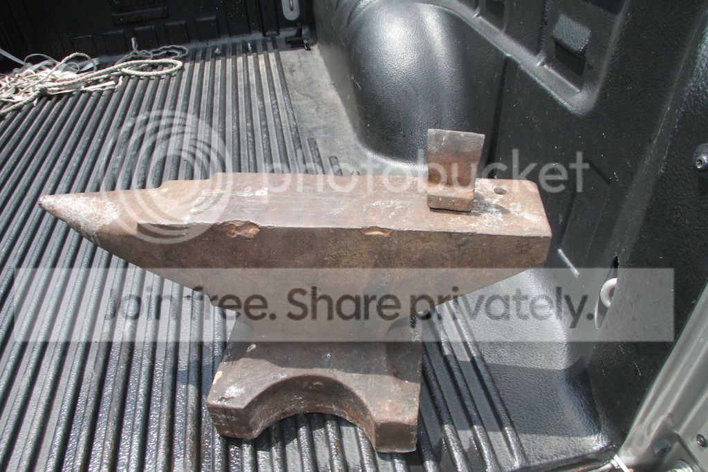

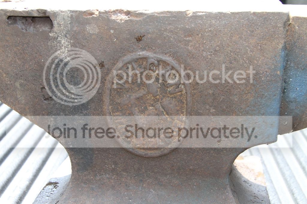

I have a lead on this Vulcan 100#. The asking price is $200, and the sides look pretty rough. I know these are not the the top o the line, but it should serve me well. My question is this: Is the price fair for the condition? The top looks pretty smooth, and it has a decent rebound. The spot right under the steel plate worries me a little.
Thanks in advance!!
Just an inexprienced anvil owner here but I would personally if I got that try and weld fill in the large space under the top plate on the one side and take a disk to the edges and smooth them up a bit. If its still got good rebound and all then the rest of it should work fine.
Not sure of the price but doesnt seem too bad, still I would maybe point out the parts you need to work on and maybe hagger the price down some.
Thanks Quint. That was my thought exactly. Problem is, I don't have welding supplies, and I can get a new 70# NC for 300. Is that spot going to crack if I accidentally hit it?

Use the chip outs as leverage to knock the price down and then I'd fix the edges and corners.

Dont think its alot of work, its just a few things. Probably much less work then your first forged knife to be honest. See what the guys say over there but I am pretty sure it would take what half an hour to weld up that one portion, another hour or so maybe dressing the top and sides and you have yourself a good anvil.

It's little high for a Vulcan. But, Vulcan's vary in quality. I see the casting flaw and it could cause the top plate to crack. But, if you are careful you can work around it.
If you decide to weld it take some time to research the repair. You'd be welding cast iron to tool steel. Tool steel should be warmed to 400+ degrees before welding. The exact temp varies. I'd use the anvil as is until you gain experience and knowledge.
The NC anvils are okay. They have a thin waist and therefore not a lot of mass under the hammer on the sweet spot. I'd hesitate before getting one myself. I bought my 300# Fisher for $360 after serious searching.

I would get the Vulcan. Especially if you can get the price down. You should be able to resell it later if you find a deal on a better anvil.
Have fun!!
I'd pass on that anvil.
