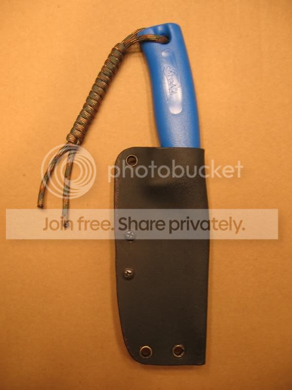

I figured since I made my inaugural effort for the Mora 760, I'd post this in the Survival forum.
I recently put together a complete set of equipment for making Kydex sheaths, and this is my first one, which I made today. This will be the first of many incidentally. This one won't win any beauty contests, but it seems to fit the knife well, and will serve me from a practical standpoint. I chose the Mora 760 for my first sheath because I hate the stock sheath.
I learned a lot on this trial run, and expect the next one to be a lot nicer. I think the next one will be for a Swamp Warden.
Here she is:

Thanks -- yes I can tell already that it's tricky. I'm going to make a few more sheaths before I start adding things like firesteel loops and hand made belt loops. Every tutorial I ever read indicates that forming the Kydex for a proper fit is more an art than a science, and I already realize how true that is.

This was the main error on my sheath. The top rivet is way too high, and in order to get it so that the knife doesn't stick I had to work the Kydex so that the opening is bigger, and as a result the knife rattles around a little. It snaps in securely, but it rattles. Luckily the Mora is so light. If it were a heavier knife I'd worry about it coming loose.
This will be one of the main changes in my next sheath.

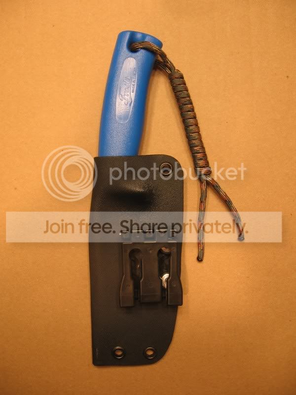

Here are the fruits of effort #2, which I did for my Swamp Rat Swamp Warden. Little better. I also removed the top rivet on my first one (for the Mora 760) and it now not only functions better, but looks nicer as well.
