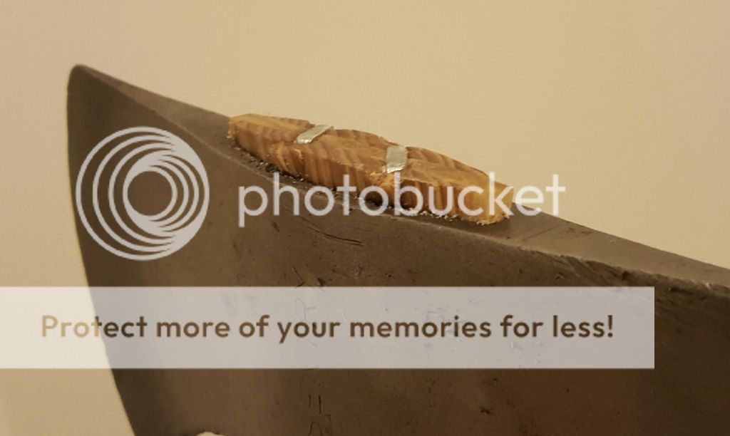

Glued up my wood wedge and sunk it as deep as i could with a rubber mallet. Looked like it wouldn't hold in the edges. So i drove both of my steel wedges to fill the top of the eye. Shouldn't have used both zamak wedges. Hopefully this isn't a problem later. I'm using mineral oil to swell it, seems to be going pretty quick. It's swelling nicely and probably didn't even need one steel wedge. I'll know better next time.
Nah, you're good. As long as the wedge is tight and the head is seated, you should be good. The metal wedges will be fine...they just make it harder to re-hang later is all. Looks great so far...nice job!
Good, and thanks! It is on there really tight and still has a few days to swell. I'm probably going to leave it sticking up that high so if there's a problem I can saw the top partially and free up enough of the zamack wedges that I can grab them with pliers or a vice and get them out relatively easy.
I'm swelling it with food grade mineral oil and it's going fast. My dad said they used to swell theirs with used motor oil. DO I need to use something else in case I ever have it out below freezing? Saw a thread on here with a blown out eye. I would think that the only thing that could do that is a really tight haft that expands with the extra force and volume expansion of ice. Motor oil or anti-freeze would solve that problem?

Haha, I know the feeling. The whole hang looks great (wedge and fit) so I wouldn't sweat having it out in cold weather. Looks like a job well done.
The mineral oil will eventually evaporate, so as long as you keep maintaining it, it should be fine. BLO is used a lot because it's a dryoing oil that creates a bit of a barrier, but it still needs to be cared for as well. I think it'll do great.

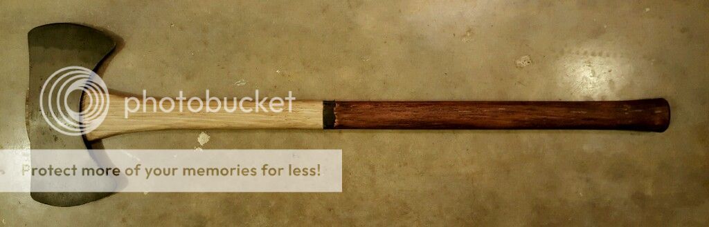

Well if there's one thing I'm good with it's a mill file. There's a couple stages of sharp above this, but it will do. This was about 2 minutes with a file and a few passes on leather. Steel didn't seem incredibly hard though, harder than my machete's but not by a lot.

Putting the final touches on it tonight. Only sharpening one side, leaving the other as it was last used by my dad. I'm going to paint over the stain line with the company colors to clean up the look of the haft. Most surveyors will mark all of the property corners they accept with flagging and our two colors are red and white. Should look pretty good.
