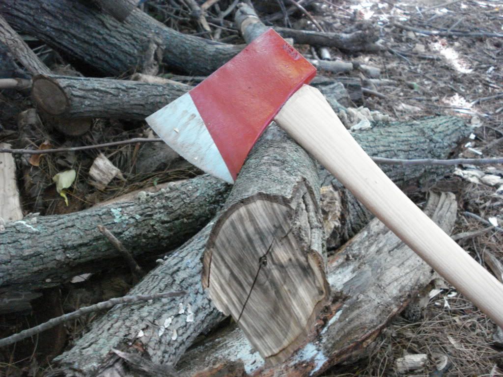

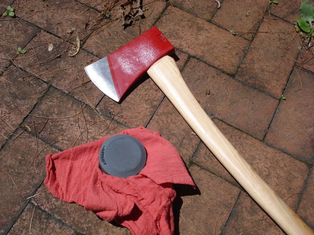

I saw some recommendations and a great youtube review for the Council Tool Boy's Axe and saw an incredible deal for one on an auction so I pulled the trigger and it got here today. I realize I'll have to spend more than 10-15 minutes putting an edge on it but I couldn't hold out any longer so I went out back and gave it a try.
Home made

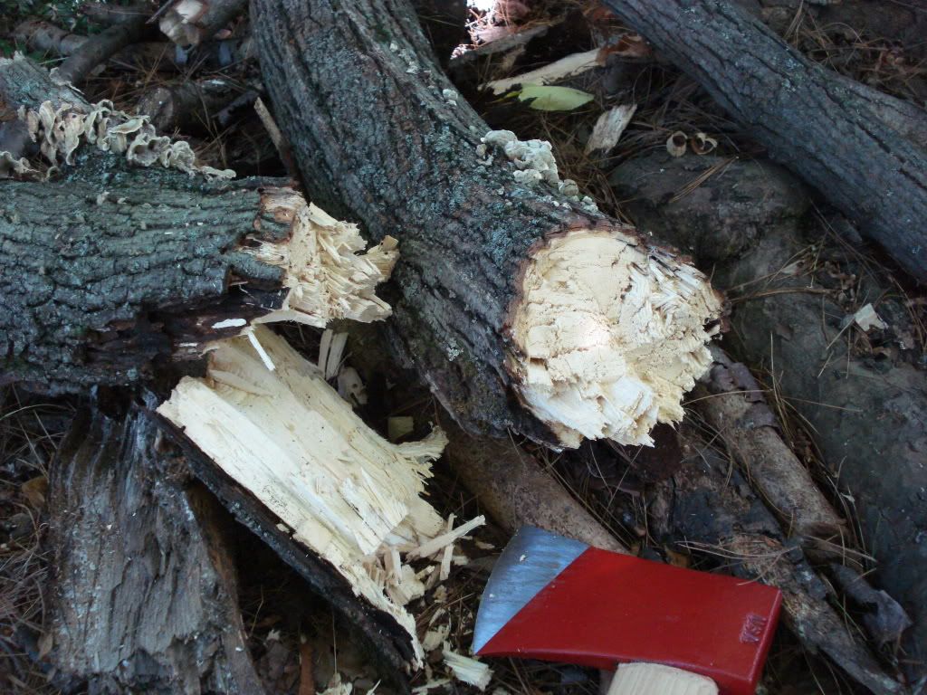

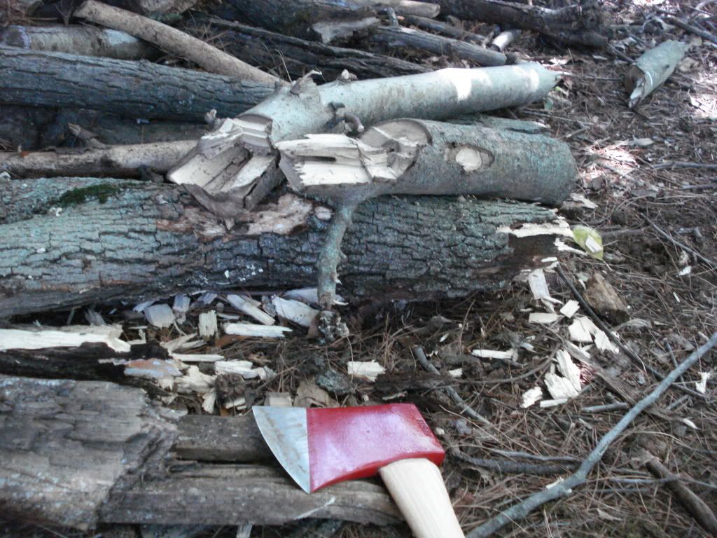

Four chops! Alright, so this piece was rotten, but it still felt great.

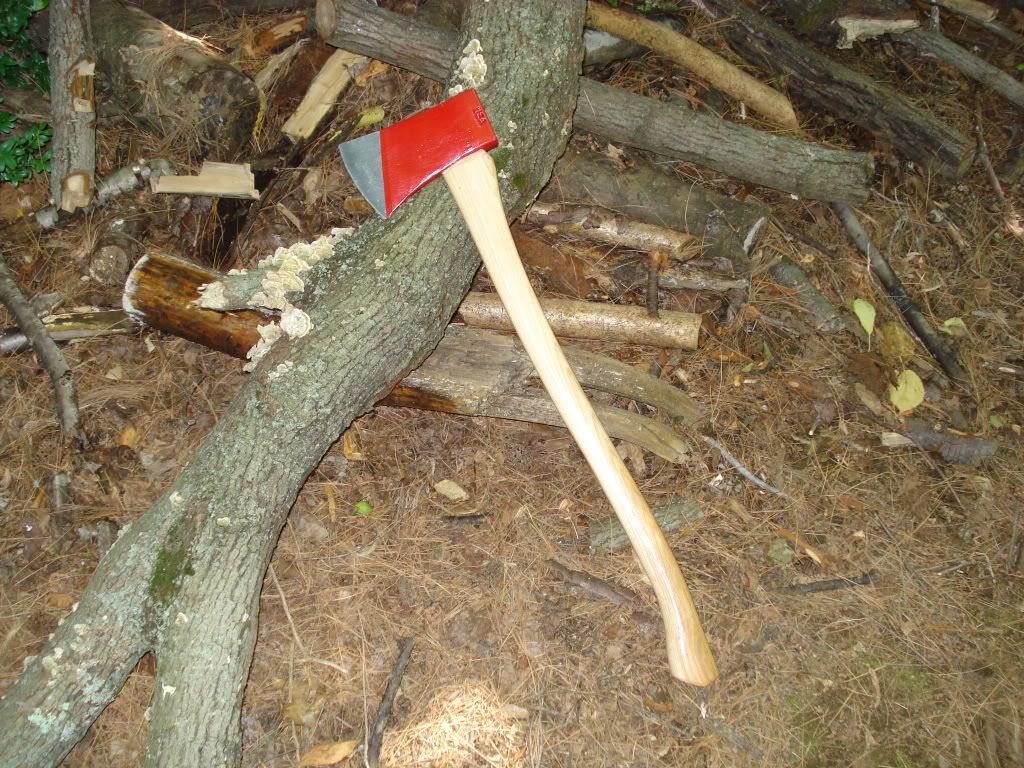

This one looks like more of a challenge.
Looks like someone's home

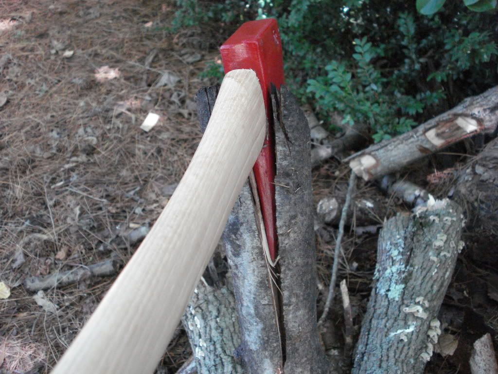

About 10-12 whacks

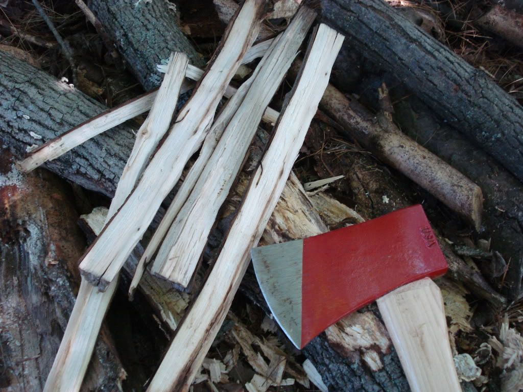

Some light splitting
Since it's my first, I don't have much to compare it to but at 28", I felt like I had good control and good put some force behind it without having to worry so much about it sinking into my leg. I could choke up and do the splitting and felt a lot of control and not having to put much energy into it to get the job done. It worked great and I can't wait to get a good edge on it to see what it can really do.

i love mine... it didnt take very long at all for me to get a razor edge on mine. it came with a near perfect 25 degree concave bit without me even touching it...

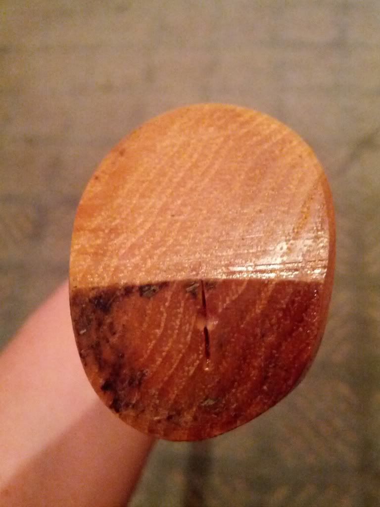

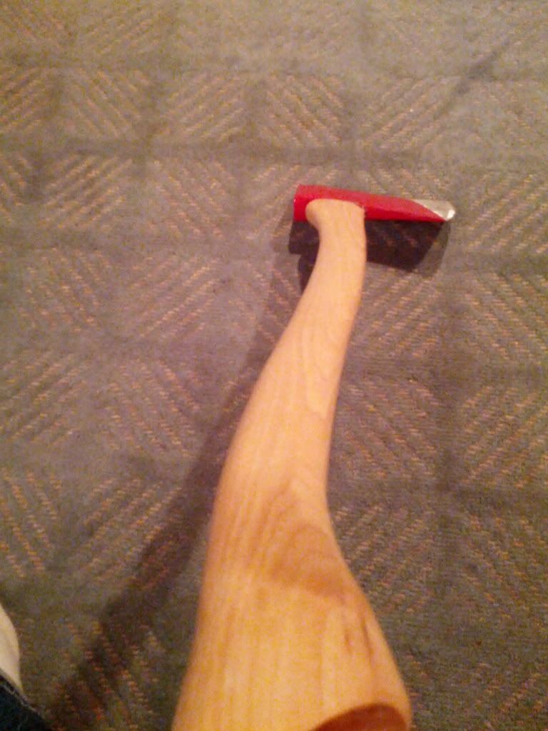

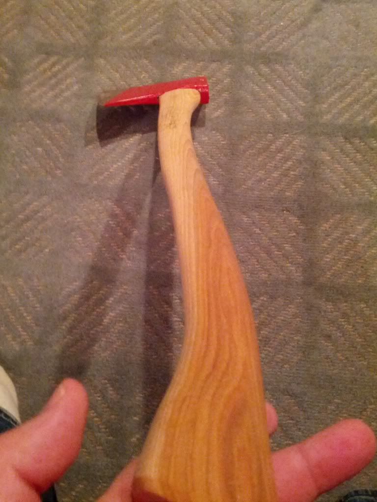

nice ... i love my Plumb Boys axe. hows the grain??

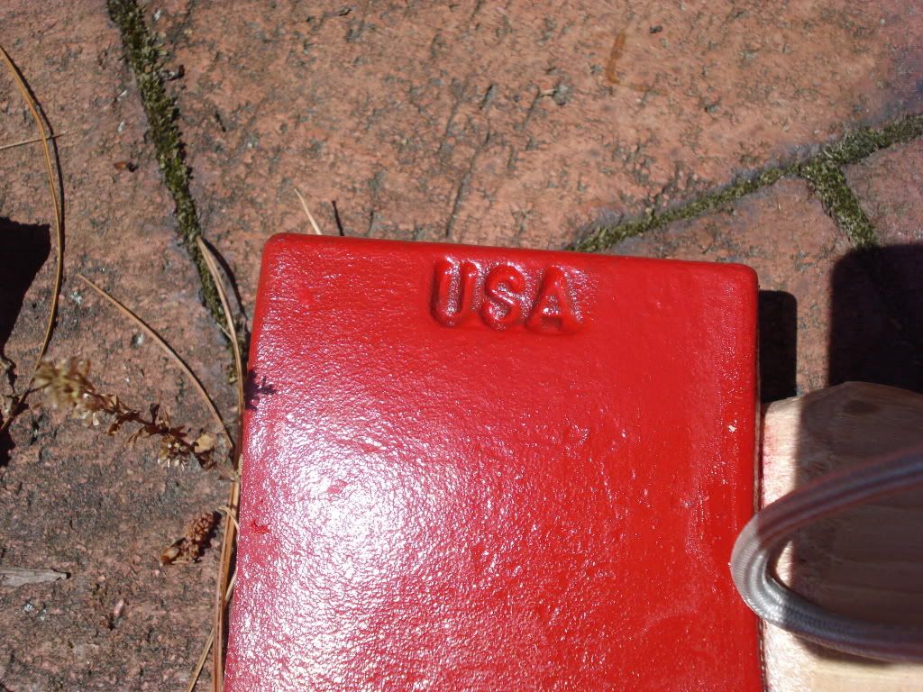

I don't think it particularly good but tell me what you think. Like I said, it was great deal and my first axe so if it's bad, let me know. The only thing available around here are the big box stores and cheap imports so I went with the inexpensive USA model available online without seeing it.
Heck, that's not to bad.
Mine has really nice grain as well, but I was able to hand pick it locally. There were a few that had really bad grain and only two that had good grain. Naturally, I picked the best of the two.
Nice, I like it a lot after seeing it
And the grain isn't so bad, I have one currently that is 90 degrees from what it should be. I also have one that has a nearly perfect grain that I bought (I'm talking handles only, no heads). The best place I have found around me is flea markets. I found some that I really like
i would consider that grain good. is there ever "perfect" grain ?? nice pics. i'm getting one :)
That looks really good, bkoregon. The grain is plenty good for this guy. I think I might have to get one of these to try them out. See how they stack up to some vintage pieces...
Nice axe and great actions shots. That grain is definitely good enough that it won't give you issues. Congrats on your first axe. Now the addiction will kick in :)

I might have to pick one of these up. My estwing keeps giving me blisters. How does the paint hold up though?
So would I. I'd consider anything less than 45° off vertical to be OK and this haft is only 25° off vertical. Not an issue. Plus it shows the wide grain of a fast-growing 2nd growth tree. Up to 40 growth rings per inch is OK. Less than 20 is preferred. That haft has maybe 16. So it has essentially perfect ring spacing. Spend a little more time working on the edge and you'll have a great working axe.
So far so good but I just used it once. I was thinking about cleaning it up and just stripping it off anyway.
