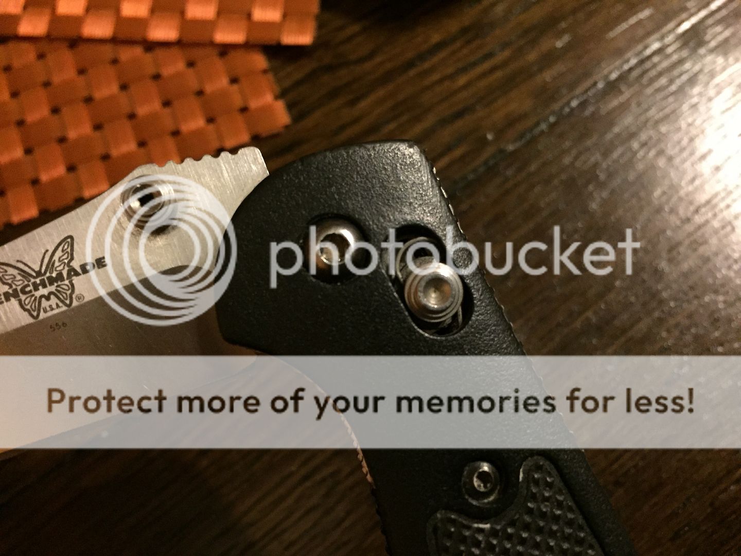

IMG_20150804_154919365_HDR_zpsce7iuvrf.jpg~original
I've had a couple break. Its a very thin wire which will eventually go after enough opening and closing. Unfortunately my knife is in and out of my pocket constantly at work which doesn't help. I still love the Axis lock because of the sheer speed it can be opened and closed one handed. Just wish they would mail you extra springs instead of having to send in the knife which is a pita. I have a duplicate of the knife I carry which I'm using for parts and currently in the process of sending in for a spring refill (taken both springs now).
